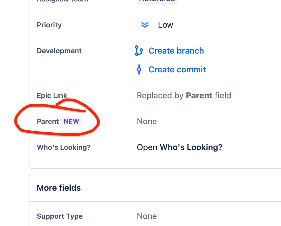

fwiw, the proposed solution didn't work... after converting my subtask to a task, it still shows up in the parent as a child issue. It even said when I did the conversion that it would destroy the parent relationship, and says that it is a regular task (not a subtask), but still it is displayed as a child issue in the former parent. Maybe because it was a closed issue when I did the conversion?
Edit:
So apparently now when a task is made a child the epic is change to a link to the parent and a new parameter appears in the right-hand panel of the child, titled: "Parent:". This doesnt go away even after the child is converted back to a task from a subtask, and so the child-parent relationship still exists. There you can click on the icon of the parent, which brings up a drop-down, with the existing Parent selected. Click the "x" on the right side of the parent to delete that relationship.  Worked for me.Screenshot 2024-01-02 at 10.23.41 AM.png
