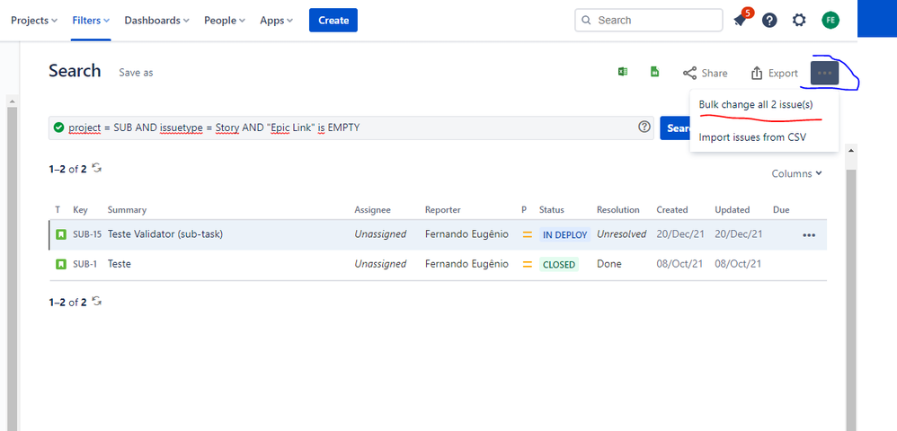

You will need to create a JQL query to bullk change the Story issues with no associated epic.
See how:
Create a new JQL query that looks something like this:
"PROJECT = XXXX AND issuetype = Story AND Epic link is EMPTY"
This will bring up all the Story issues of this project with no associated epic.
Once this is done, click on the 3 dots located in the right corner and click on "Bullk change"

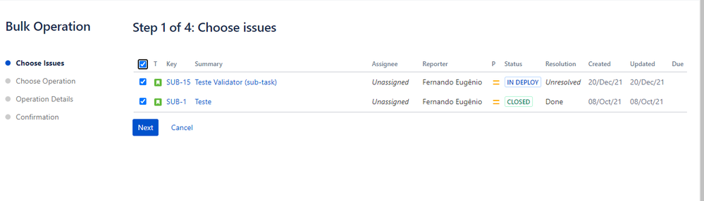

This next screen will appear, check all issues and click next

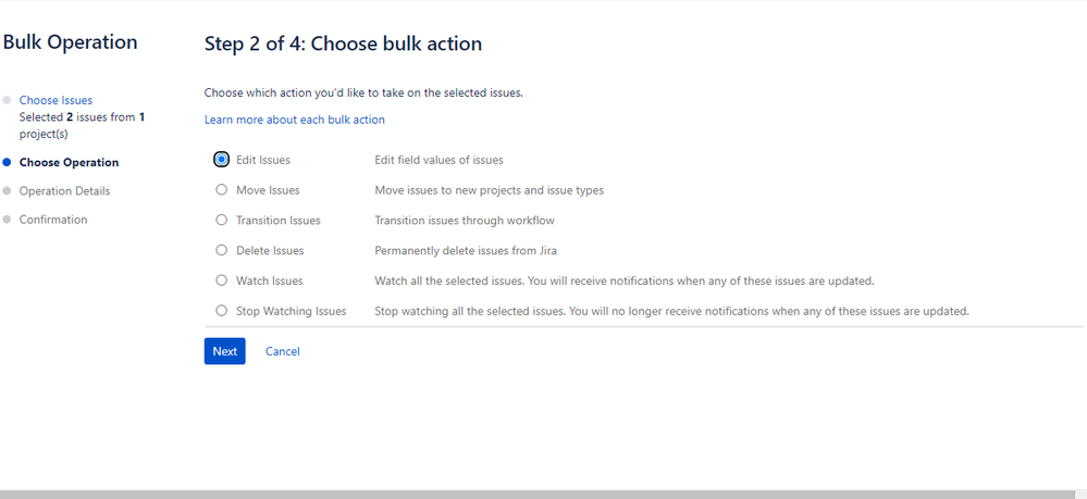

On the next screen, select the "Edit issue" option and click Next

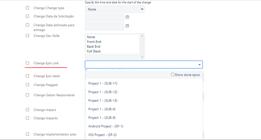

Now on this next screen, search and select the "Epic link" field. It should list all the Epics you have created to associate these issues with this epic.

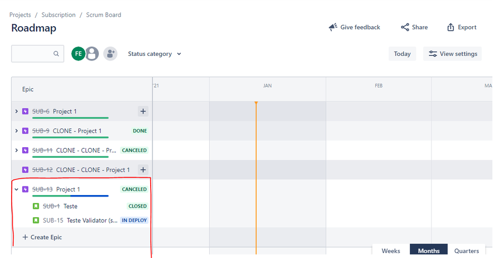

Accessing the RoadMap this will be the view you have:

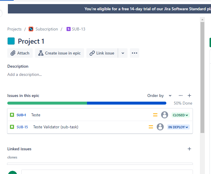

And if you go to the epic where these issues were associated, you will see them as follows:
