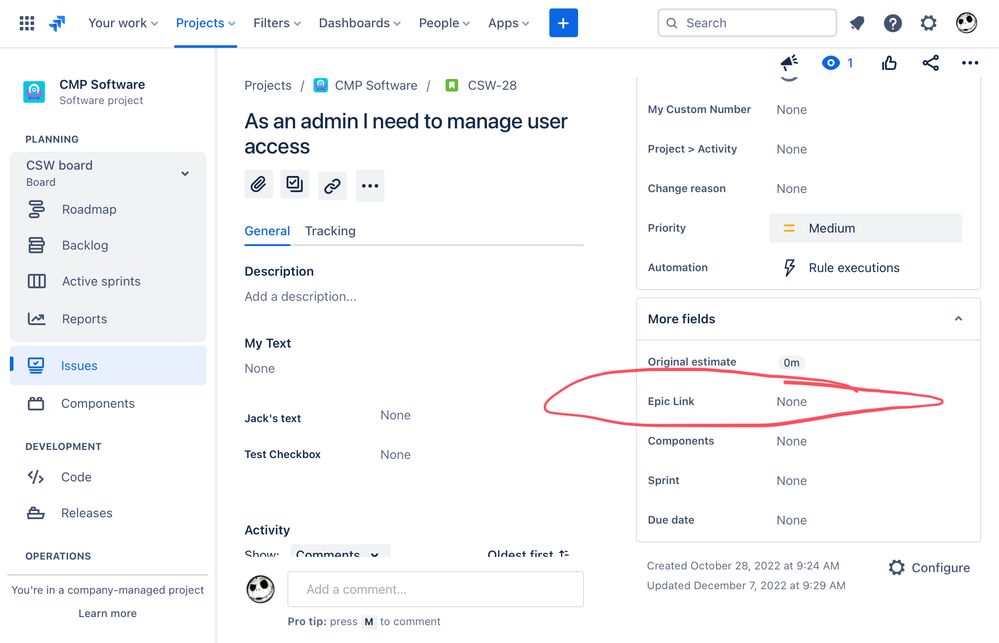

the new issue view does away w/ having to go to another screen to edit. in the new view you should be able to edit any displayed field directly. If your field is not shown then you would need to add it to the screen, if it is available.
If I go to one of my stories that is not currently attached to an epic and I click the "show more" link then I see Epic Link none. I can then edit and change none to the desired Epic Name. If it isn't there then you need to go to project settings > Issue Layout and edit the layout associated w/ story. If it isn't listed then you need to ensure Epic Link is on the screen config.

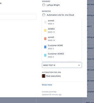

?? here is what i get...
I click to the right, not on the link, and backspace select a new epic.
Ah. Not intuitive. But works. But not intuitive. Does that surprise me? No it does not.

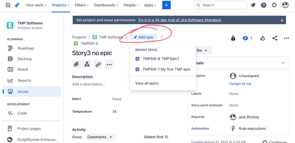

Assuming that you create an issue not from within the Epic itself then...
If you are using TMP...
if in a CMP project...
