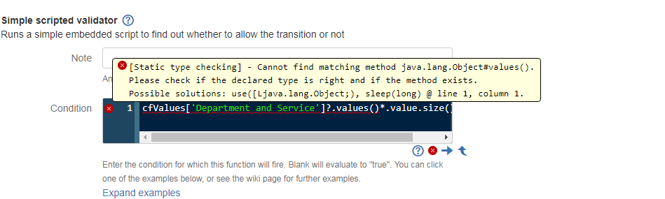

NguyenThanh Hoa
May 16, 2018
I use this Script
"cfValues['Department and Service']?.values()*.value.size() == 2"
and meet this Error. Please hepl

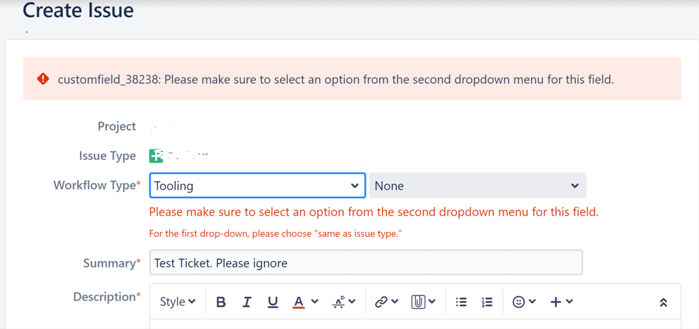

jira_admin_cu
July 12, 2023
@Ma Haoao's solution worked for me.
Use "Simple Scripted Validator" on the workflow validator, and ignore errors.
Output is :
Like NguyenThanh Hoa likes this

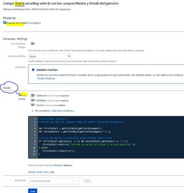

Lender
November 23, 2020
@JT4 ,
You can try this with behaviours:
Script:
//23/11/2020 [Leandro]
//Script que deja el segundo campo de select cascading obligatorio
def firstSelect = getFieldById(getFieldChanged())
def secondSelect = getFieldById(getFieldChanged()+":1");
//Si la sub-opcion no estuviese seleccionada, emite error
if (firstSelect.getValue() != [] && secondSelect.getValue() == null){
firstSelect.setError("Informe la opcion principal y la sub-seleccion.");
} else{
firstSelect.clearError();
