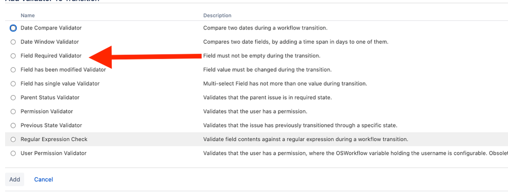

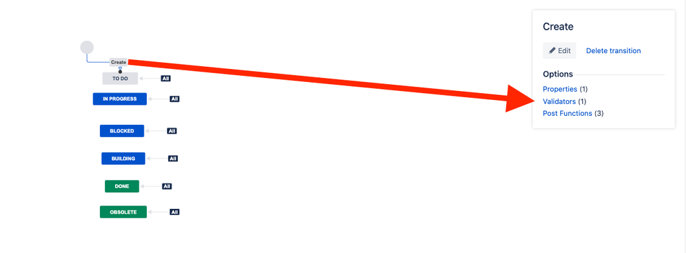

For a Company Managed project you could edit the Create transition in the worrkflow to include a Validator to require the fields to be filled in.
This is for a Company Managed project, mandatory for 1 project (not across all fields). Haven't decided if I want all issue types yet.
I'll try your instructions above, thank you!
This worked; however, I would like to customize the issue types so that they are not mandatory across all issues. Any thoughts here?
