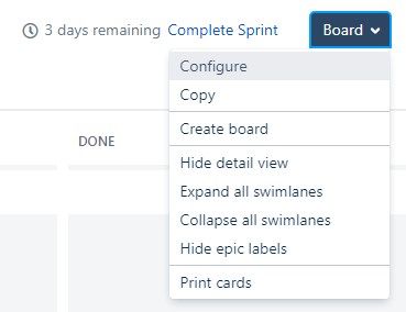

Go to Board Configuration Page

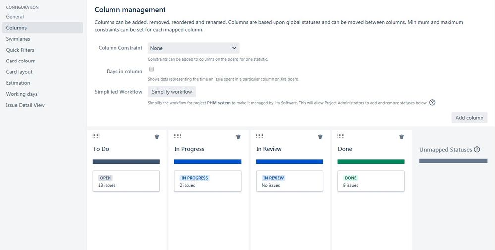

Check whether the status are mapped to each columns

My suspicion is you have these statues in your workflow but they are not mapped to any status on your board.
Can you ask the board admin to go to Boards>Configure>Columns page of your project and make sure the mappings work as intended.
