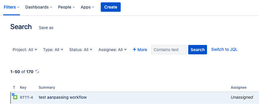

Hi @Briony Lambert ,
In Jira you can search for issues via Filters-Advanced filters and save a filter.
With a Board of a company managed project you have the option in Board settings to choose a different filter.
So for the stated situation you create 7 filters that find the desired issues and you link a filter to the specific board.
Does this help you?
Regards, Marco
