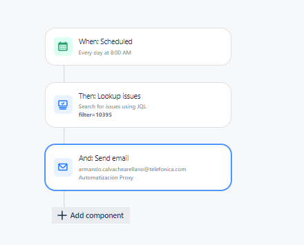

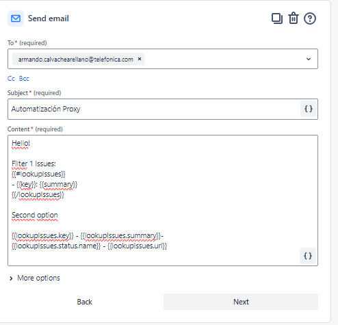

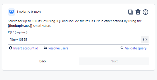

I leave them attached. As you can see, the automation is composed of three blocks. The periodicity block, the filter block (the number 10395 is the ID of the desired filter) and the mail block where I have two options written.
Thanks for sharing, but the syntax you use in the email is incorrect. Correct syntax:

It doesn't work when I type that. Do you know if the fact that nothing is printed in the mail is due to an error in the lookup issues block?
To be certain, can you open the filter, copy the jql and put that in your action for the lookupIssues ? Then use the validate query button, it should get some results :)

I have found that by searching in jql and typing filter = 10396, Jira returns all 23 cards. The problem is when writing it in the lookup issues of jira automation.

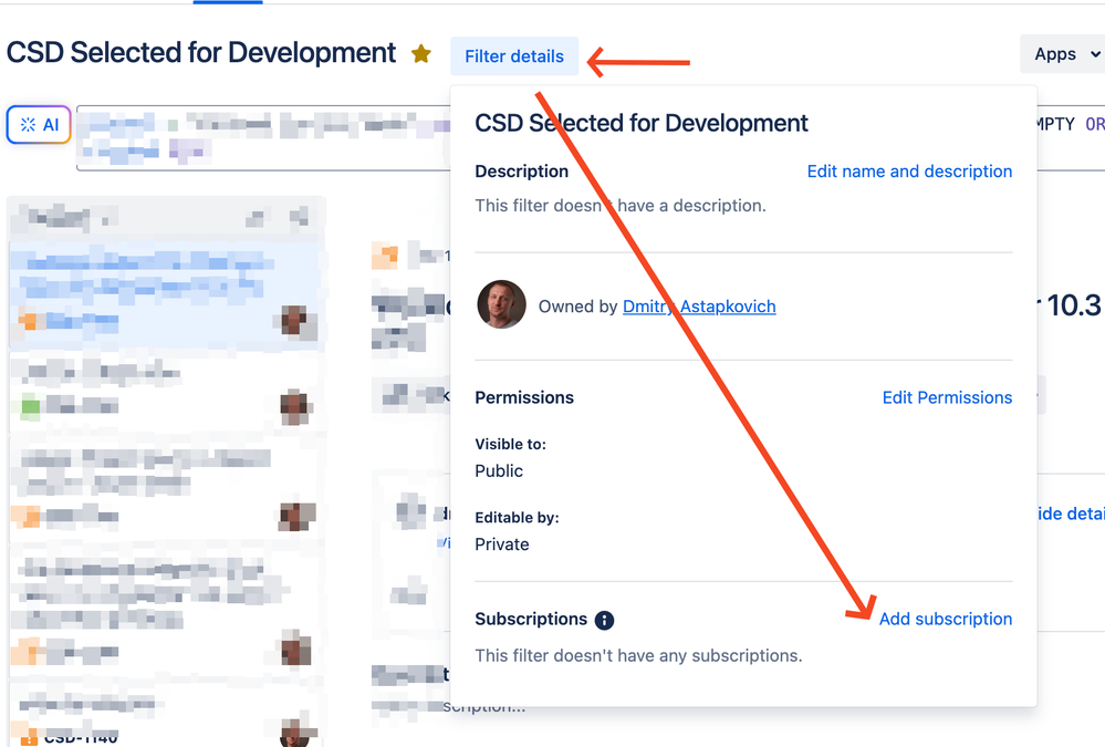

Have you tried adding a subscription to a filter?
Yes, but I want to send that info to another user, not only for me

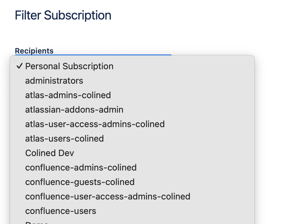

You change the subscription from Personal to Group:
Understood, and is it possible to customise the columns displayed?
Sure thing, columns setup is a part of filter.
