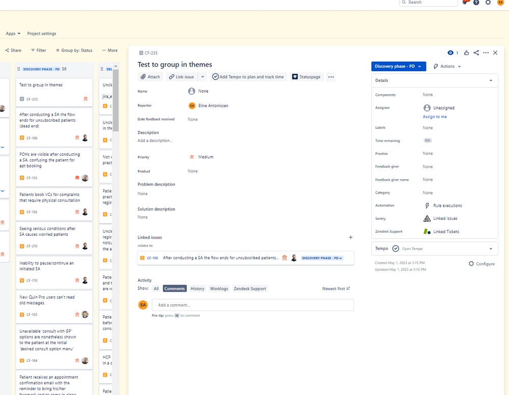

I tried to add a 'theme' issue type but I can't find a way to add other issues while not showing those specific tickets on the board anymore...

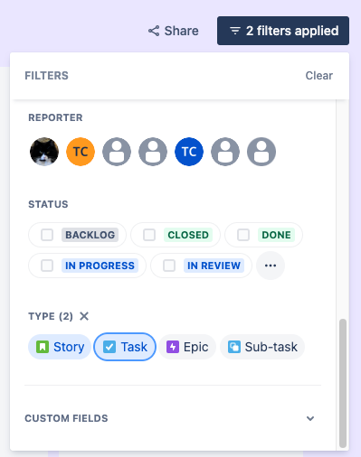

The Board for a Work Management project will show all active issue cards in the project, except for issues classified as "sub-tasks". You can use the Filter option to select the types of issues you want to display, and thereby exclude display of the Theme issue type. Example:
Do you need to keep track of the movement of the Theme through the statuses, like you do for Feedback? If not, you might want to consider using the Category field to apply a categorization to your Feedback issues instead of connecting them to a Theme issue.

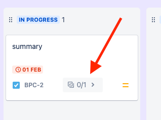

Subtasks do not show up as separate cards on the board. Instead they show up collapsed under their parent issue.
The parent issue shows the number of its subtasks that are "done" (0 in the example) vs. the total number of subtasks for that parent issue (1 in the example).

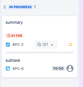

If you click on that "0/1" area the parent card expands to show its subtasks. BPC-6 is the subtask and BPC-2 is the parent.
Parent and subtask issues can have different statuses, but the group will show all together in the column that matches the parent's status. In the example above, the parent issue BPC-2 has a status of In Progress, so the parent and all its subtasks are in the In Progress column even though the subtask has a status of To Do.

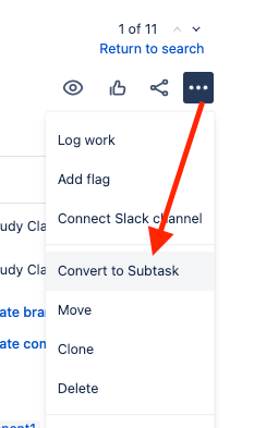

To convert the Feedback items one at a time from standard issues to subtasks use the Convert option you can find in the ... menu when viewing an individual Feedback issue.

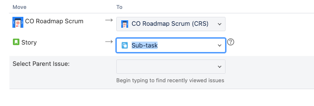

You can also use the Bulk Change option from the Advanced Issue Search screen. Filter for all the Feedback issues that you would want to make subtasks under a single issue. In the Bulk Change wizard select Move Issues as the action. Then reset the issue type to subtask and specify the single issue you want to become the parent issue for the converted issues.

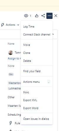

Thanks! For some reason I am not able to adjust the issue type. Any idea what could be causing this?
Trudy P Claspill
May 30, 2023
You will have to first add a Sub-task issue type to the Issue Type Scheme.
https://support.atlassian.com/jira-cloud-administration/docs/add-edit-and-delete-an-issue-type-scheme/
