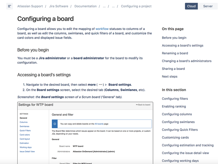

Can no longer find my way to the page referenced here:  https://confluence.atlassian.com/jirasoftwarecloud/configuring-a-board-764477974.html
Keith Mertens
December 15, 2017
Hi Carlos,
I'm not sure you've answered the question I meant to ask.
The webpage link works fine, but I'm not sure where the equivalent of step one on that page is... i.e. "select more > board settings"
Where is "more"?
How do I get to the board settings page?

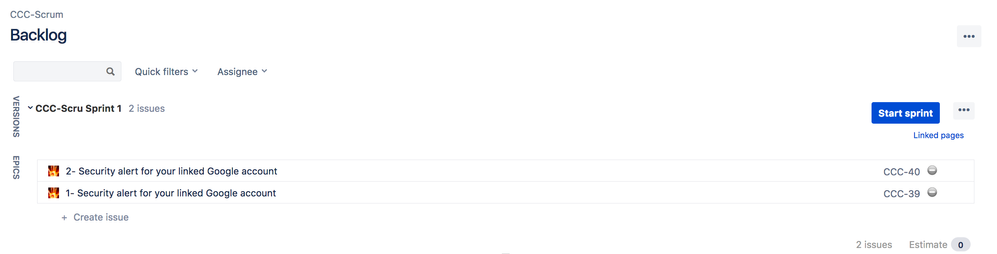

I understand now, thanks for the clarification! In the new JIRA UI you'll find the three-dots icon in the right corner of the board:

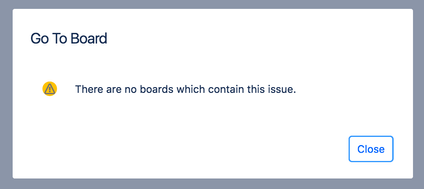

As I was trying to find a way to make this work, I converted the project from a business project to a software one, but then I couldn't associate a board to the "new" project. From the configuration I tried Agile->Manage boards and ran into this error:
