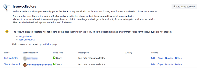

I can view the issue collector I created when visit the control panel. Here is a screenshot of the list of collectors:

Hi Rachel,
There must have been something wrong with the Issue Collector I was trying to use. I created a new one and it worked with the format you shared.
