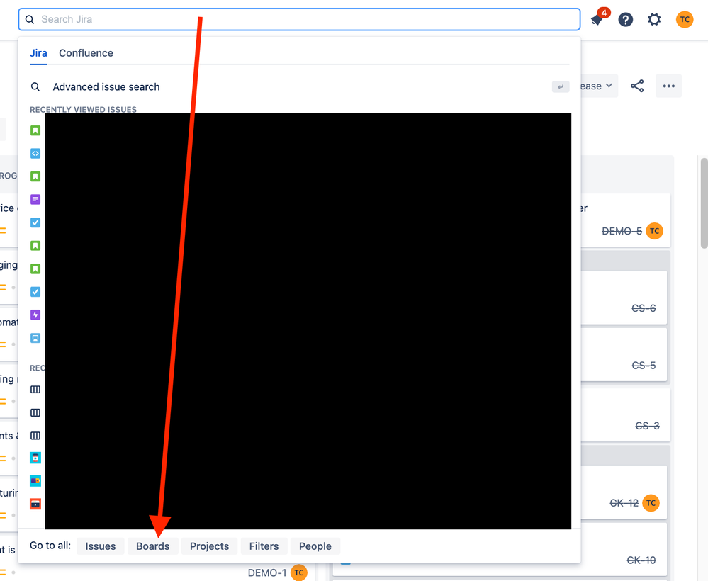

To manually create a board you can click in the Quick Search field in the upper right. When you click there you'll get a pop-up and at the bottom of that pop-up is a Boards button. Click that.
The next screen will show you a list of boards and there will be a Create Board button in the upper right. Click that button.
Select the type of board you want to create.
In the next screen you specify what you want to base the board on. Select Existing Project and click Next.
In the next screen you specify the name of the board, the projects to reference in it, and the location. You can select multiple projects here.
Note that the people who view the board will need to have Browse Projects permission for all the projects you select, and Jira Software Application access to see the board.
If another project is added to the system later, you can update the filter used by the board to include the new project. Creating the board creates a Saved Filter, so you would just have to update the Saved Filter for the board.
An alternative would be to create a Saved Filter first, and to not specify any Projects for that filter. In that case the filter would pull issues from every single project in the instance from now on, without having to be updated when new projects are added. Then when creating the board you would select Saved Filter instead of Existing Projects. But again, your users who view the board would have to have permission to all the projects in your instance.
