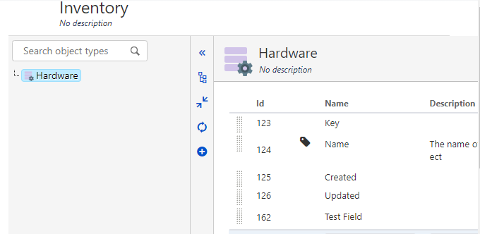

I have a basic Insight Scheme set up:

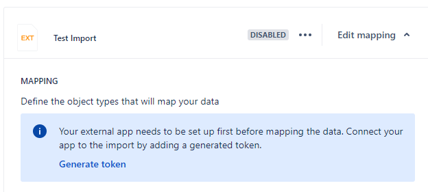

I also have the import set up, key generated and working:
