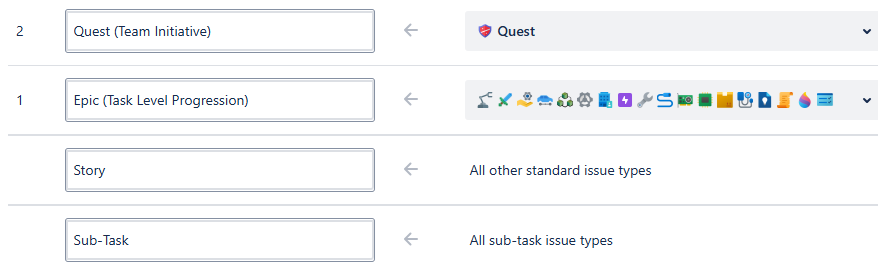

Dan Spearing
March 9, 2025
Thank you for the response. This makes sense.
Due to the "configuration" I inherited, I'm going to try and solve this by trying to adjust the hierarchy up, rather than down.
It appears that the simple timeline that only shows Epics is the limiting factor so I will also have to also work with the Plan view as well.
