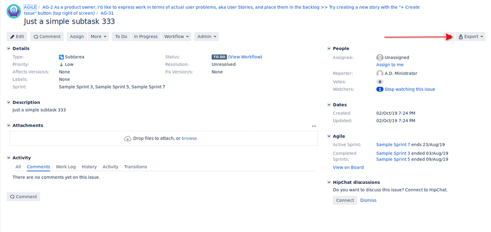

On Jira server you will find the option at the top-right in the Issue View:

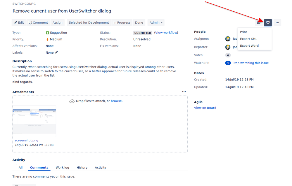

On Cloud using the old Issue view it is also more or less in the same place:

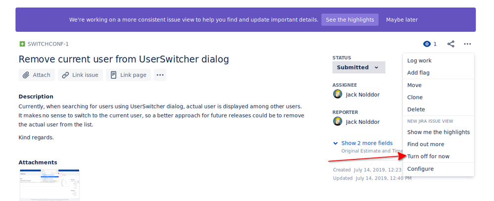

On Cloud using the new issue view it is not possible, so you have two alternatives here:
1.- Disable the new issue view

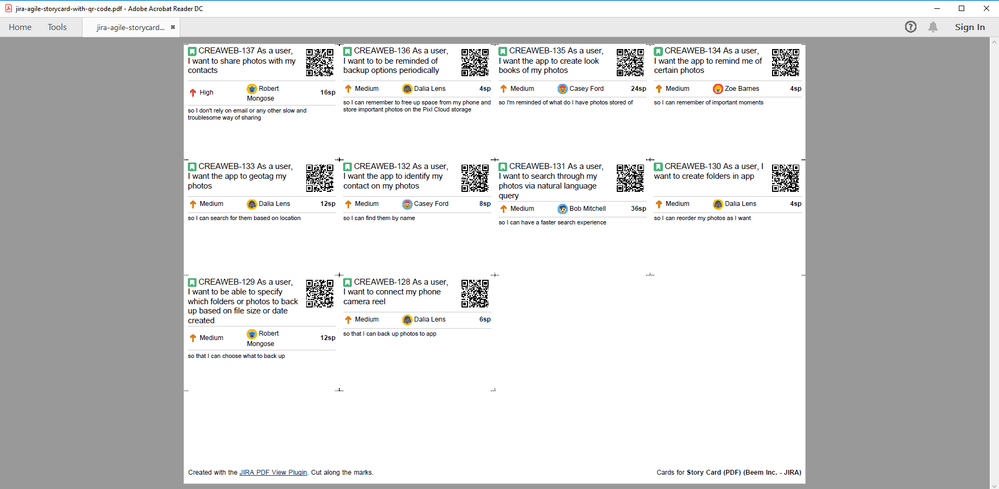

You could also try Better PDF Exporter as an alternative of the built-in export feature. It supports Server, Data Center and Cloud, too.
It has a customizeable template to generate story cards, see the sample below.
(Disclaimer: I'm a developer working on this.)
