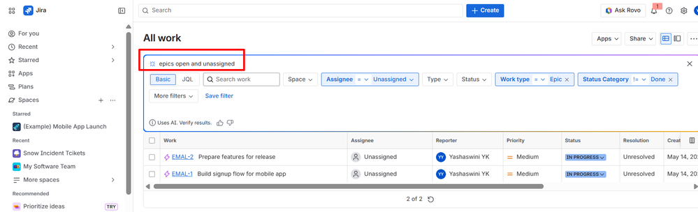

If you are on Premium or Enterprise Jira plan, "ASK AI" option will be available where you can use smart queries in the global search.
Organization admin would have to enable the Atlassian AI features for Jira app at global level to use these features.

Hi Neal,
I agree the search experience has changed from the older smart query behavior, but Rovo should still handle these queries reasonably well as shown in the below snapshot.
Please try tweaking the prompt a bit and see if that helps with the results.

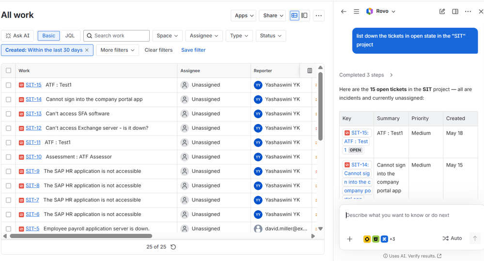

Hi - thanks I did try that but it was less than useless. I typed in BCARE BB1 so that should find all tickets in BCARE project with text BB1. Instead it gave me a whole document of ideas. I just wanted that to save me doing an explicit search by project which now seems the only way to do it

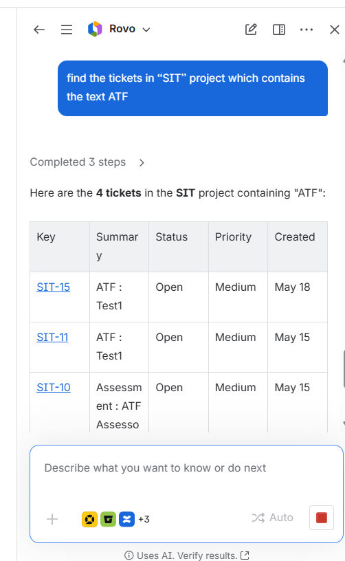

Rovo prompts seem to work better when more context is provided instead of shorter smart queries.
I’ve attached a working example below. Please try pasting this prompt into Rovo :-
find the tickets in “BCARE” project which contains the text BB1

Hi - thanks for trying to help. No this is not what I am looking for. That gave me an almost unreadable list of tickets in a small corner of the screen. What I am looking for is what I have been using in JIRA for over 20 years - a query that produces a list in Issue Navigator that I can then modify as needed (e.g. add additional filters. sort, save as filter etc.). I just need/want my Smart Query searching ability restored and no one can figure out how to do that for me. Thanks

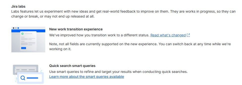

To turn it on, click your profile icon in the top right, go to Personal settings, scroll down to the Jira labs section, and enable Quick search smart queries.

Yes, thanks - ChatGPT gave the same answer. But there is no option in the JIRA Labs section to enable Quick Search smart queries. All I see is a useless note (see picture). Our JIRA admin does not know how to enable

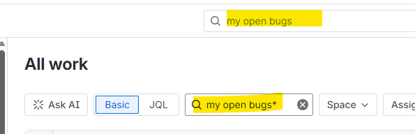

Try one quick test: hit / to pop open the quick search and type my open bugs. Does it actually filter your tickets, or does it just treat it as a plain text search? It's also worth asking a teammate on the same site if they can see the toggle on their end.
The official documentation still states the same thing shown in the screenshot you attached.

Yup - that's exactly what I tried, and it just does a text search "my open bugs"
