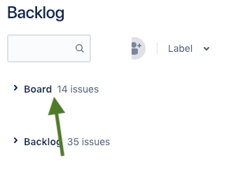

I have dozens of issues in my next-gen project in the backlog. The backlog has two regions "Backlog" and "Board". The issues in the "Board" region show in the TO DO column on the main board view. The issues in the Backlog region do not show on the main board view.
I am using an issue filter to sort my issues in the backlog in a particular order, and wish to do a bulk change of the issues from "Backlog" region to "Board" region. Is there a way to do this? What about a bulk change from "Board" to "Backlog". See image below...

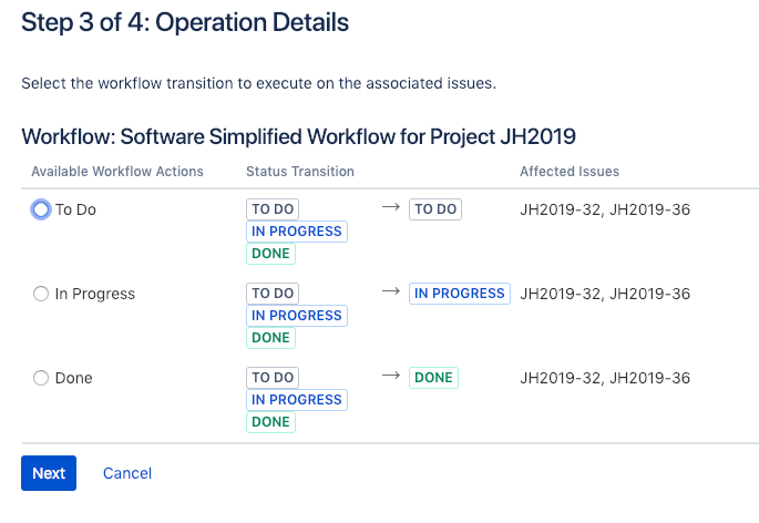

James MacEwan
January 10, 2019
I do have permissions to bulk change. Looking at "Transition Issue", there is no distinction within TO DO between "Backlog" and "Board".

To recap: You want to move many issues from Backlog/ To do --> Board/ To do:

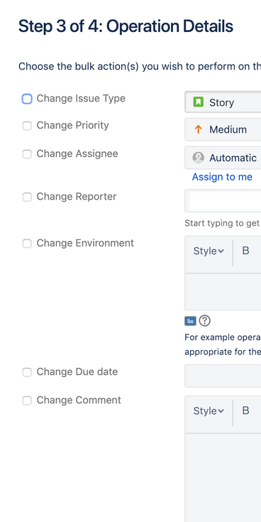

  1. Bulk change - Edit Issues will not work, because status is not an editable field.
  2. Bulk change - Operation Details will not work because "To do" status is in both board and backlog workflows

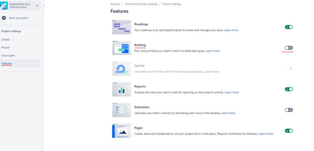

October 10, 2019
I found a roundabout way to do this. If you go into your project settings and under Features, turn off backlog, it will move all items to the board. You can then turn backlog back on and it will ask if you want to move items back and say no. Not the most straight forward but it did work to get my 50+ items off the backlog and into To Do on my board

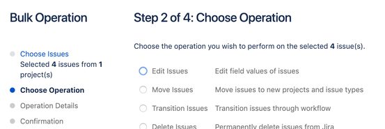

The key to the question is what to pick within the bulk move.
The issues are already in TO DO status, and I want to move them within TO DO. So the "Move issues" operation doesn't seem right. In the "Edit issues" option, I do not see a field for moving within TO DO from "Backlog" to "Board".
I've attached some screen shots.
Step 2
Step 3

Alyia Hammond-Williams
October 10, 2019
I found a roundabout way to do this. If you go into your project settings and under Features, turn off backlog, it will move all items to the board. You can then turn backlog back on and it will ask if you want to move items back and say no. Not the most straight forward but it did work to get my 50+ items off the backlog and into To Do on my boardbacklog.JPG
