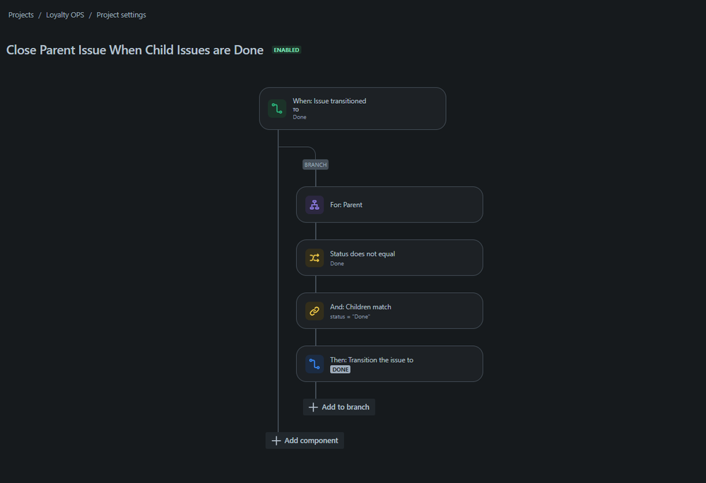

1. A screen image that shows your entire rule.

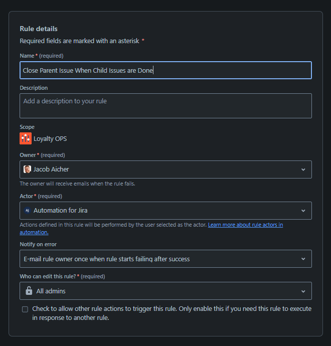

2. A screen image that shows all the details from the Rule Details page.

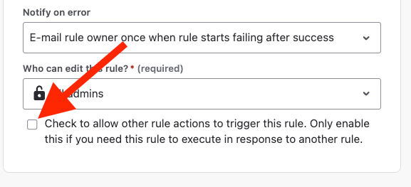

One thing that may be affecting your scenario is that the rule may not be getting triggered if it is the rule that causes the Story to be closed.
There is a checkbox on the Rule Details page that you have to check if you want the rule to be triggered by actions that are completed when an Automation Rule executes.
If that box is not checked, and the rule is triggered by the transition of an issue, then when the rule is initially triggered by transitioning a subtask, and the rule then closes its parent story, the transition of the parent story will not retrigger the rule to assess if the parent epic should be closed.

Thank you! Happy to be here. Below is a screenshot of the of the rule setup. I used a template for this and made no adjustments.RuleDetails.PNG
Here's a screenshot of the Rule Details.
Your explanation is now making sense. This rule is working the way I desire for my Stories. Whenever I close all Sub-tasks that live under a Story issue, the Story automatically closes.
This is the same functionality I am looking for when it comes to all Stories closing underneath of an Epic and having the Epic automatically close.
After testing out the use of "Check to allow other rule actions to trigger this rule", the rule is now working both for Sub-tasks closing Stories as well as Stories closing Epics. So thank you for this! This resolves my issue!
