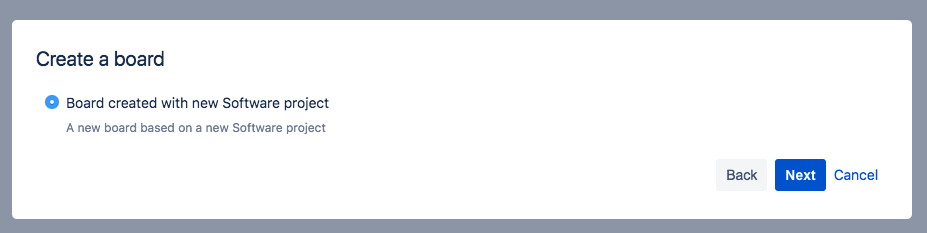

The new JIRA doesn't give me an option to create a board for an existing project from that screen....

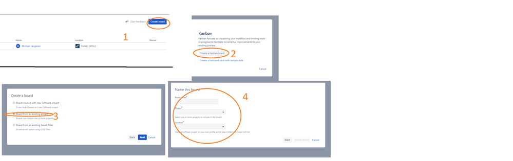

August 30, 2019
Yes ofc.
I am trying to create more than one next gen boards. As i have move through the community forums I have discovered that it is a (feature?!) to only have one next gen board. This is beyond my comprehension.
I have to oversee a project in  different departments, but under the same dev cycle; eg I need to have a roadmap with epics, stories, tasks and different boards for: Design, Engineering, Dev etc. They each have their own workflow, so filtering is not an option.
