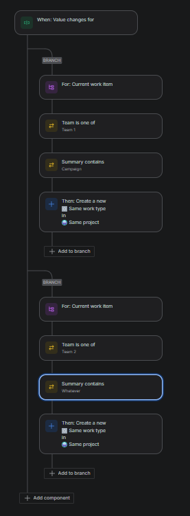

Manav Shah
October 7, 2025
Hey @Suzi D'Apice-Chen ,
I think this should be an easy one.
I have build a dummy for you, see if this works out for you?
Suzi D'Apice-Chen
October 14, 2025
Thank you so much, Manav! let me try this out and let you know
