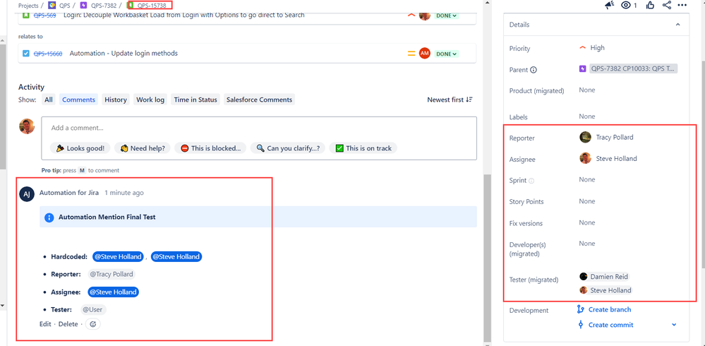

@Bill Sheboy  i tried a bunch of times in our sandbox but im screwing up the syntax...
same issue as above; we have a customfield (tester) thats a multi user picker...i just want the automation to @ the people listed in that custom field in a comment...here's my code...and the result i currently get without that list iterator stuff done right :)  Any guidance appreciated!
________________________________________________________________
{panel} *Automation Mention Final Test* {panel}
* *Hardcoded:* [~accountId:6127b46f3ef46a007078ecf5] , [~accountId:6127b46f3ef46a007078ecf5]
* *Reporter:* [~accountid:{{issue.reporter.accountId}}]
* *Assignee:* [~accountid:{{issue.assignee.accountId}}]
* *Tester:* [~accountid:{{issue.customfield_49919.accountId}}]

For a multiple-selection, user picker field an iterator must be used, as described in my earlier post.

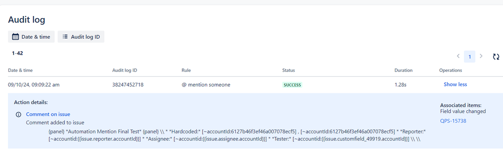

If that does not help, please post images of your complete rule, the action where the mention happens, and of the audit log details showing the rule execution.  Those will provide context to help explain what you are observing.

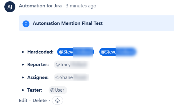

Thanks for the response @Bill Sheboy     its not that it didn't work, i just definateyl didn't do it correctly. it was a bit too "syntaxy" for me to be able to pull off :)
  • We are on JIRA CLOUD
  • Audit logs show success and it is "succesful" as a rule, its just not printing what i would like for the results of that multiselect

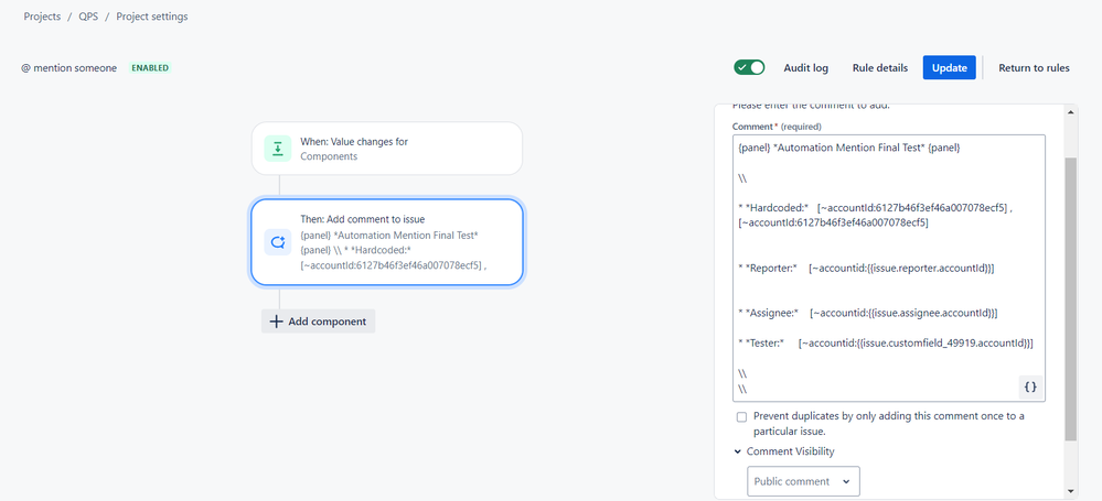

  • below are the screenshots of the rule(simple just so i can test it) and its results that it produces and the log of success

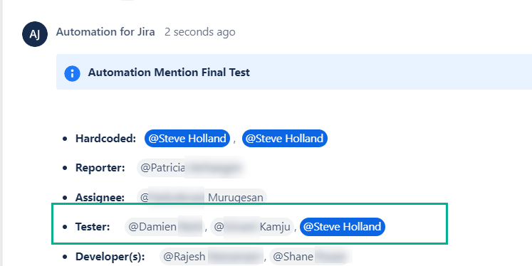

And...for the multiple-selection user picker field Tester, please try this to mention all the selected users:
{{#issue.customfield_49919}}[~accountId:{{accountId}}]{{^last}}, {{/}}{{/}}
 Please note well: smart value expressions are case-sensitive, so confirm this exactly matches what you try.  (When the wrong case is used, the expression often evaluates to null and shows no errors.)

That worked @Bill Sheboy !   i must have originally screwed something up in the sysntax.  appreciate the help very very much!JIRAmentionmultiselect.png
