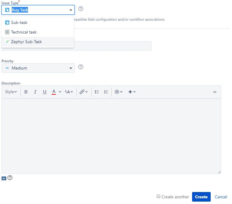

baytulbhuiyan
April 19, 2018
2018-04-19_11-56-57.jpgAre you guys talking about this?
Like • # people like this

Senthil Selvakannan
November 18, 2019
JIRA Settings - Issue Types - Add Issue Type.
In Add Issue type box, select "Sub-Task Issue type"

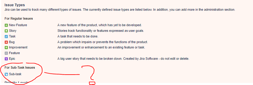

thisnamenotused
April 17, 2018
I am new but I don't think this what everyone is wanting.
Explained:
I want to address a bug while working in a certain user-story because the bug occurs on the same webpage-step that the user-story does.  So I just want to tell everyone that "hey, while I am making changes to this page/user-story I will also attempt to address this bug."
We would think that since we already pulled up the subtask modal and are defining the subtask that the Issue-type dropdown would either not be in this modal at all or at least allow other sub-sub issue types such as "bug."
If this is not the way it is supposed to work then please show where in the Atlassian documentation I should be looking for how to communicate. What is the proper alternative to a sub-task-bug?
sub-issue.PNGWhy is this even in the documentation at all if there is only one. Add bug to that list as well and after you create it add a pop up that asks: "Would you like to clone this bug to an external issue for recording purposes or in case you can't fix it within this user-story?"
Nic Brough -Adaptavist-
April 19, 2018
As an admin, go to the "issue type scheme", and add "sub task bug" to the scheme.  You may need to create the new type first.
The documentation is simply showing the defaults.
