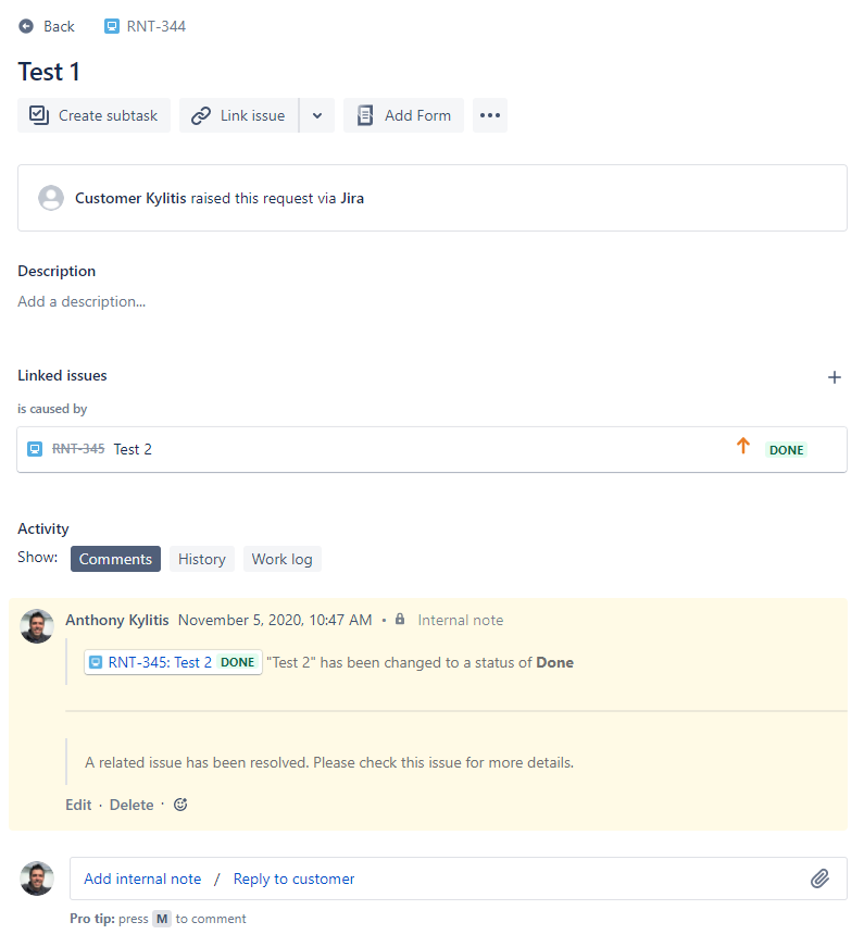

Anthony Kylitis
November 5, 2020
Support helped me find the issue. It was a Legacy Automation rule that was getting me. Apparently, it's a default rule that gets introduced. I deleted the rule and added it back as a new Automation rule. I guess I didn't check Legacy Automation since I figured they were discontinuing this feature.

Anthony Kylitis
November 5, 2020
Here's a screenshot. You can see it also introduces some text in the comment that says "A related issue has been resolved. Please check this issue for more details." Clearly this would be easy to locate if it was an automation rule doing it, correct?Capture.PNG
