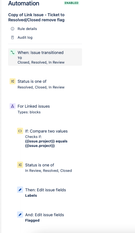

Thanks for the help! I've been trying to get it to work but can't figure out how (I don't know what the second value should be.
I think I'm doing it wrong with the second value right? I've tried {{destinationissue.project}}. I can't find a way to compare it to the project of the linked issue.
Thanks!

Hi, Max.  Thanks for adding more information!
First thing: I recommend implementing this one-rule, and one-status at a time.  Once you have it working you can decided if/how the rules can be merged.
Next, some follow-up questions:
  1. How many issues are linked for blocking: one-to-one, one-to-many, or many-to-many?
  2. If one-to-many or many-to-many, are issues linked in chains of A---(blocks)-->B---(blocks)-->C
If you have anything other than one-to-one blocking links, you could get into a situation where it is not possible to determine "flagged" or "not flagged".
If you only have one-to-one links, rather than using branches on links you could use a branch on JQL to set a created variable based on the linked-issues information, and then use that to decide about flagging.  The JQL to get at the linked issue would be:
issue IN linkedIssues({{triggerIssue.key}}, "blocks")
