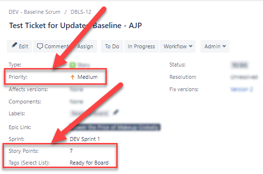

Below is what I am referencing for the issue view of just the issue itself, normally opened in a new tab when clicking on the key-# pair.

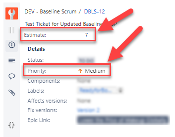

Below is what I am referencing for "Quick-View", it's the column/tab which pops up on the right hand side when clicking on an issue from the backlog or the board itself. If this has another term please let me know.

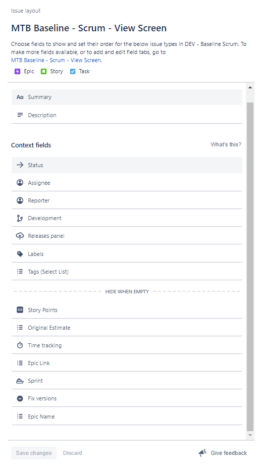

AJ Palmer
February 4, 2020
This is what I see from "Project > Project Settings > Issue Layout" and rearranging this does not seem to change anything for me on either the quick-view or issue view itself.
Nor did this screen give me the option to rename anything.
Am I in the right place?
Nic Brough -Adaptavist-
February 4, 2020
You can't re-arrange the issue view screen beyond the order of the custom fields that are not pulled out into their own areas (dates, people etc)
However, you can almost remove priority - go to the field configurations and hide it in all of them.
To swap to story points, change your boards to use them instead of estimates.  You'll probably want to remove estimates from the screens.
Your tag field will only appear in the view screen once it has data.  This is an attempt to de-clutter the issue view!
