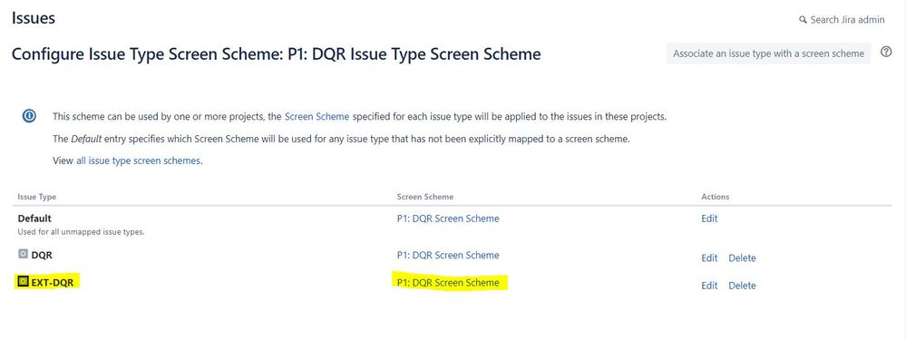

I want to change an issue's screen theme and have associated the issue type with a screen theme, as shown below:

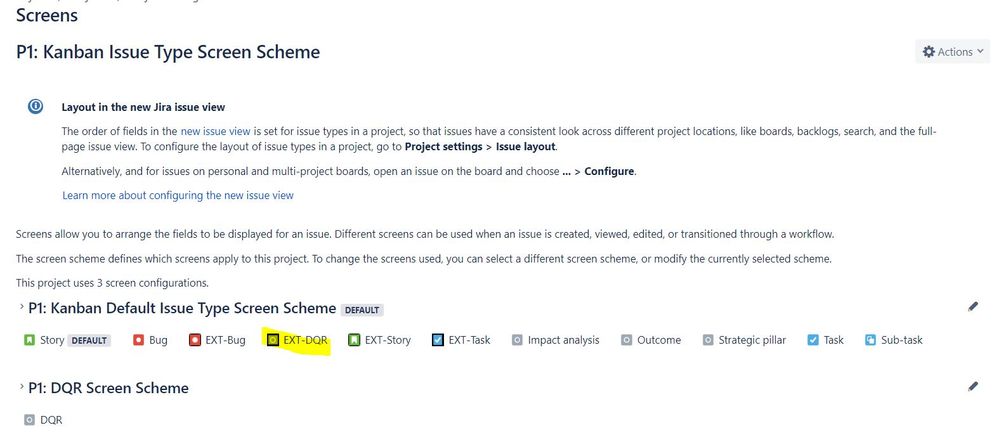

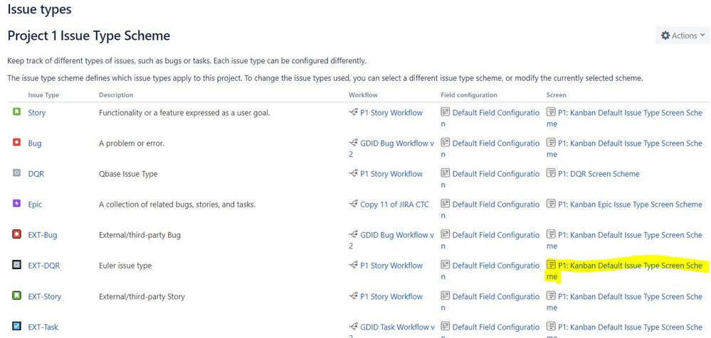

However, when I view the screens page, the change hasn't been made, as shown below:
Can anyone tell me what I've missed? Thank you.

Hello @Maxine Freedman-Thompson
In your second image you are showing the Screens page for a Project. In that page it indicates that the "P1: Kanban Issue Type Screen Scheme" is associated to the project.
That is a different issue type screen scheme than the one you modified and showed in your first image, where you show that you modified the "P1: DQR Issue Type Screen Scheme".
The issue type screen scheme that you modified is not the one that is associated to the project. Therefore the change you made had no impact on the project.
You need to change the issue type screen scheme that is associated with the project.
