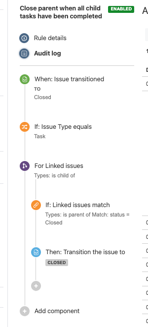

On my team, we organize our work using Story issue types and then create Task issue types as Sub-tasks, since our client has not enabled Sub-tasks in our Jira project.
I am trying to create an Automated Rule that closes the parent Story issue when all linked child Task issues have a status of "Closed."
I have attempted to set up the Automation, but when I test and look at the Audit logs, the rule is picking up Task tickets that are closed - but not resulting in any action. What am I doing wrong in my rule?

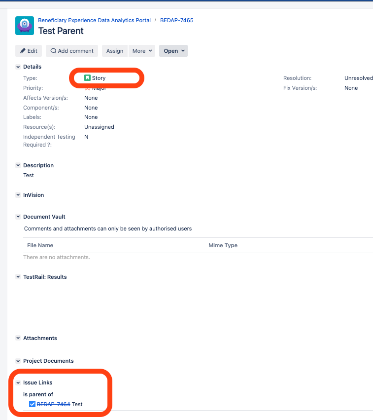

Here is an example of how we have the tickets set up.
The way the automation configuration reads, it seems to me that it should work...it is checking to see if all of the issues linked to the parent issue with the link of "is parent of" are Closed. And, if that is true, it should close the story ticket.

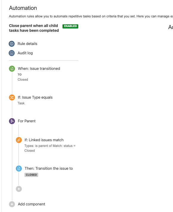

Actually, thanks to your feedback, I think I got it to work! I reconfigured it to what I have below. Yay! Thank you so much!
