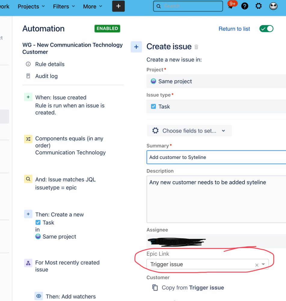

Attached is a screenshot of the setup I use for the story ticket creation:

Hi Dean,
have a look at a rule excerpt I have for doing the same...

@Jack Brickey If you reference my screenshot in the original post, I have that circled field already set. It doesn't seem to work in next-gen. Am I missing something from your screenshot?

Ah, yes. That is correct. Epic link doesn’t apply in NG. I have not done so but see if you can reference via “parent”.

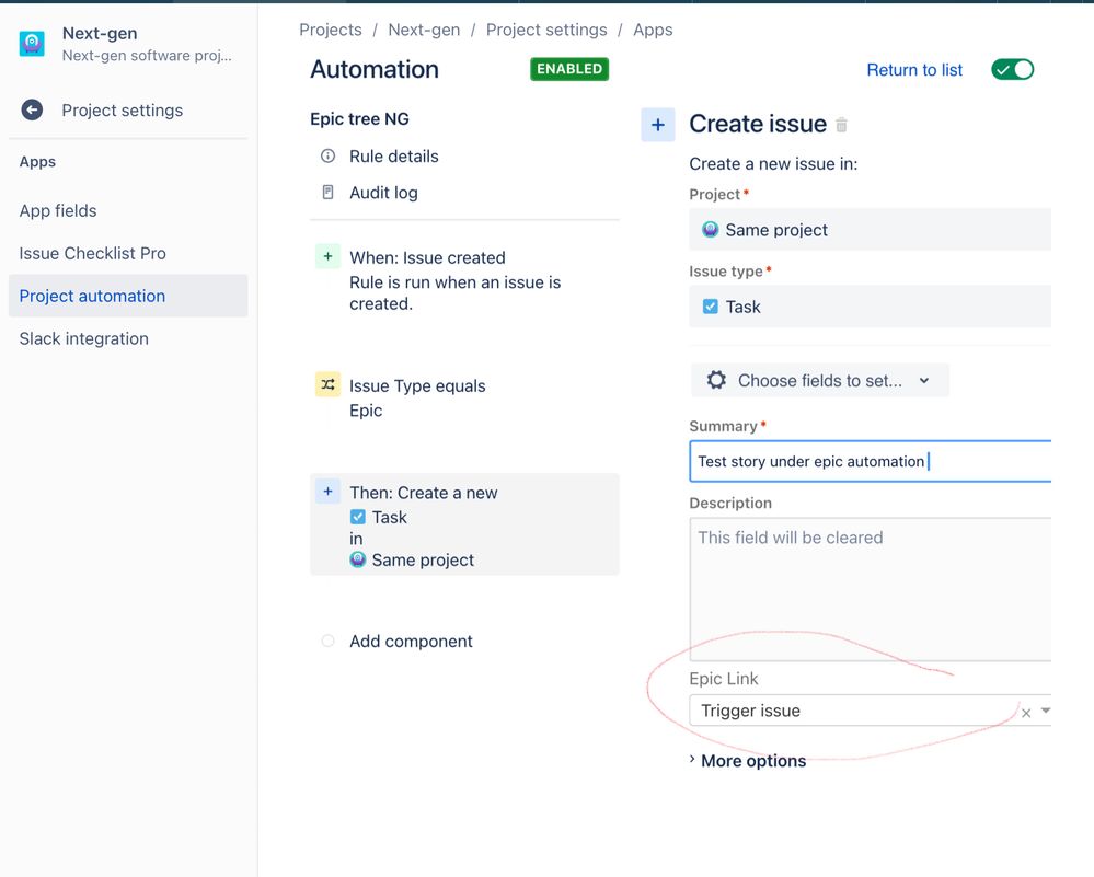

I’m unsure how to solve this in NG as I haven’t spent any time with it. If I get a chance I will look into it a bit addictive get back to you here. If you have not already search the community for potential solutions. For sure Epic Link isn’t the way to go as it doesn’t apply in NG.
Jack Brickey
February 3, 2021

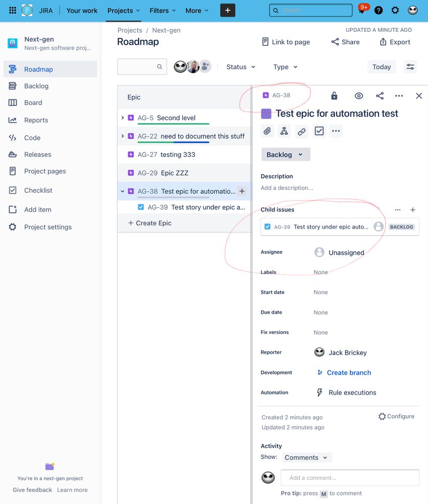

Well interesting. I just did a quick rule an in fact epic link did work so they must have fixed it.
Now I suspect there is more to your request but I will need to consider that tomorrow as I’m going offline for the night.
