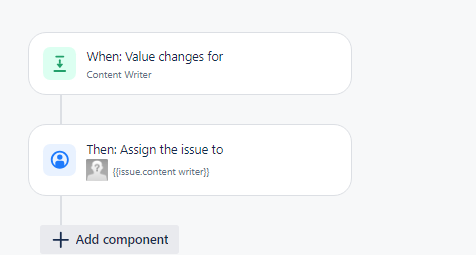

This is a try with the trigger being a value change:
This is the try:

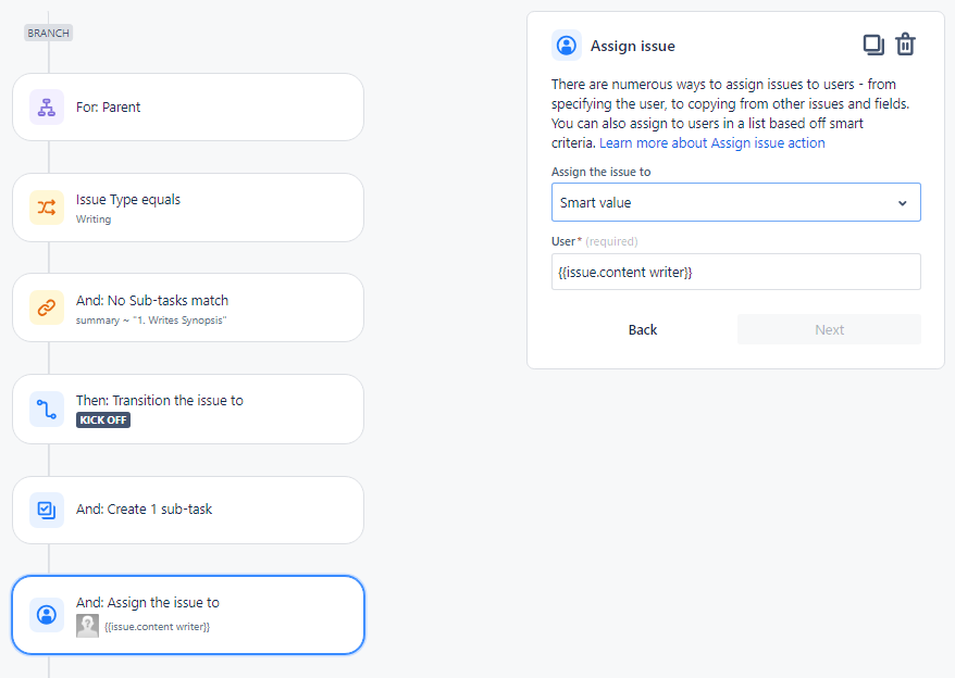

I see that you are creating a Sub-task after the auto transition. I assume you want to assignee the issue to the Sub-task and not the trigger issue When you are creating the Sub-task, why not just add the value in the Assignee field?
Click the 3 dots beside the field and click Copy. Then click on the words Current Issue and in the popup that comes, change the Current Issue to Trigger Issue and select the Content Writer field there.
Thanks so much for trying to help me. I'm new to this jira automations thing and so I'm doing my best. So I believe I have tired what you both suggested.

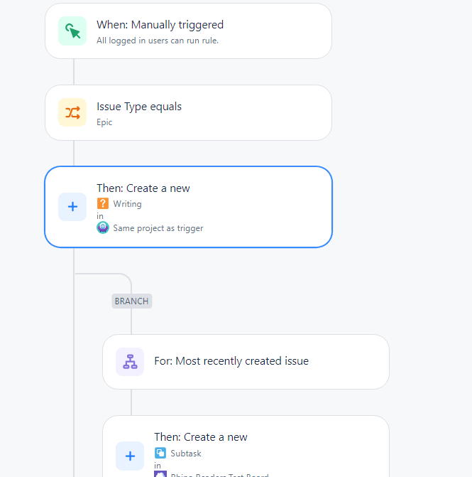

This is what I wanted to do in a nut shell:
1. The Team leader creates a new Epic (which in our project is a book)
2. When they create the epic they fill in the context people fields (writer, Editor, PO, Designer etc)
3. Then they run a manual trigger automation.
I'm a bit lost as to how to do this smart value not a smart value
I'd like the epic to always hold the various job roles and then when I create tasks and then sub tasks to change the assignees to the ones held in the people fields in the epic.
Is this possible please?
Do I need to set up a separate automation that states assignee = People Context field epic?
my knowledge is just not great I'm sorry.
This is my automation so far:
Everything works apart from the assignee.

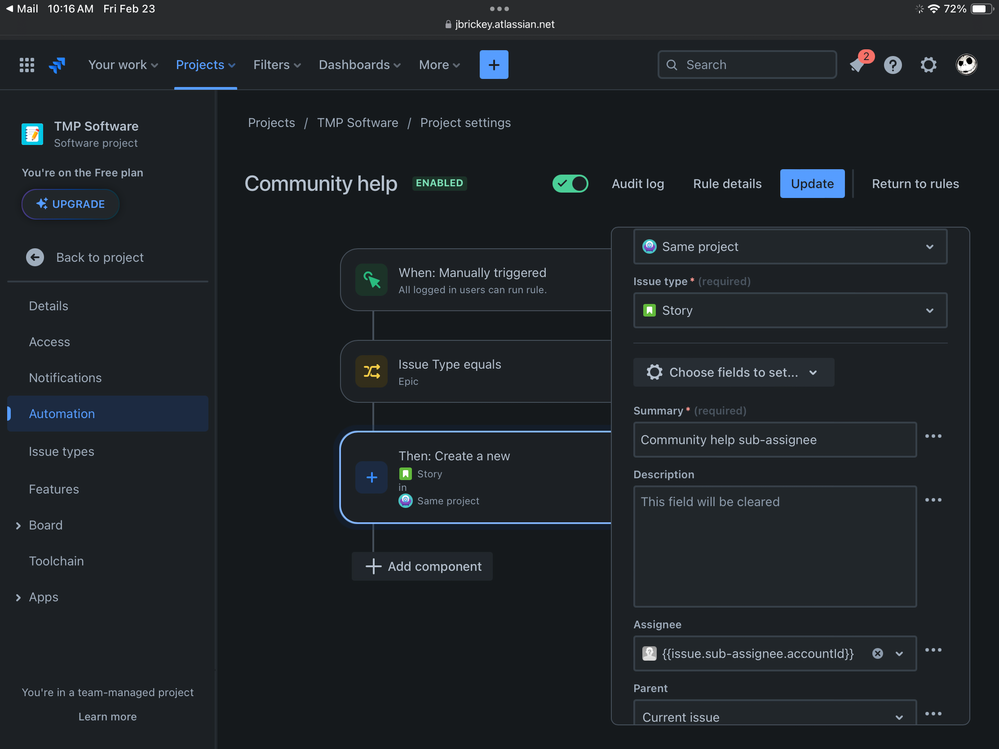

Hi @Sarah Isaacs , please share how you are setting the Assignee in each case (task, subtask).
The following works fine for me.
For the Task create I used the following smartvalue. You need to replace "sub-assignee" with your custom field name. IMPORTANT: The custom field type needs to be People type.
{{issue.sub-assignee.accountId}}
For the subtask I set the Assignee by copying from the parent (newly create task). Note I added two Re-fetch data actions to ensure the task create action has time to complete.

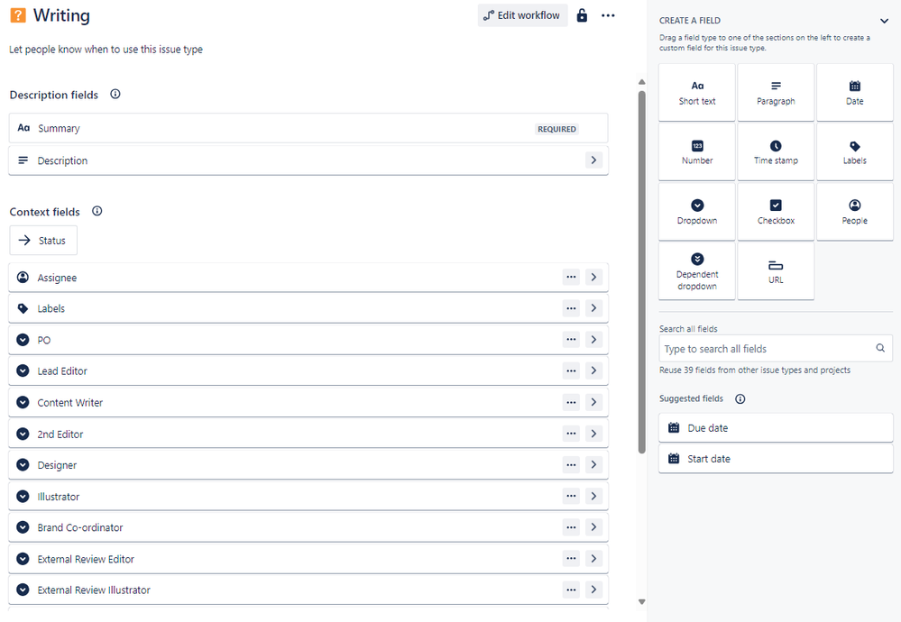

Ok so looking back at your OP you state "...but the field is not a custom field". If not a custom field what is it? You must've created a custom field that the user can select from drop-down, right? Would you mind providing an image of your automation rule. Also what does the audit log tell you when you try to run the rule.
@Jack Brickey Hey Jack, Yes this is where I create the fields:
So why I say its not a custom field I mean its not reporter, creator etc.

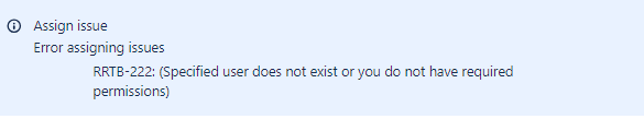

This is one of the errors I get:
The user has access and is a member. Its all spelt the same.
I'm going to try Initial and surname. But then its not ideal as I'd like their name. Can you covert a Name to the Initial and Surname if that worked. Like dare I say it a look up.

Hi @Sarah Isaacs ,
Thank you for all of the details that certainly helps. The first thing I observe, is that for your assign issue action you need to be sure that you are referencing the new subtask not the issue associated with the trigger. I think you simply want to set the Assignee as part of the issue creat action. Similar to what I show in the image below. Also, I am assuming you are using the "People" custom field option to create all of your fields (writer, editor, etc.) used to copy into the Assignee.
The smart value syntax should be as follows I think...
Hey Jack and John, Thank you so much it works. You are fantastic.
@Jack Brickey @John Funk Thanks so much for all your help the assignee worked.
