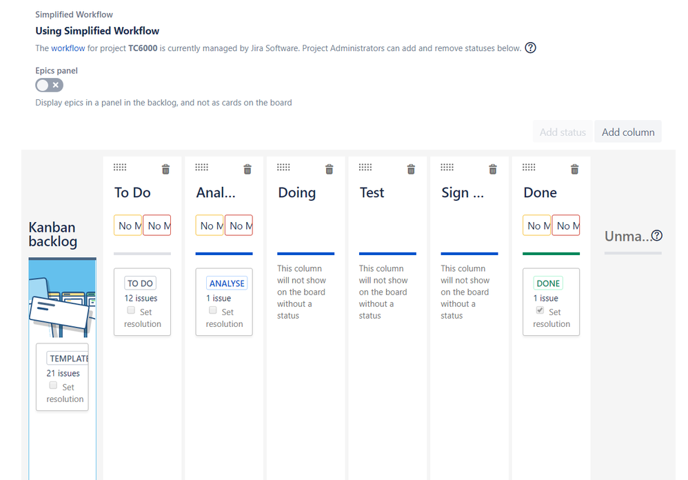

Ok, we need to see the current column configuration - right the way across, with all the headings and blank spaces beneath

Nic Brough -Adaptavist-
May 10, 2019
Ok, that's great.
You need to edit the workflow to add more status into it.
Despite the description, the workflow is not "simplified". (It probably was, but then someone copied it or applied it in a workflow scheme on a project, so it's not simplified any more).  The greyed-out "add status" button tells me the workflow is not simplified.
You'll need to go to the workflow as an admin and amend it, adding more status.
Aisling OBrien
May 10, 2019
Done, thank you :-)
