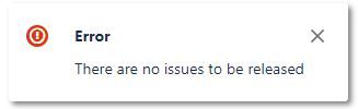

I have an issue in the Done column. Done is the last column in my chain and my Release button at the top is enabled, but when I try to add a new release I get the attached error.Capture.JPG

Hi @Heinrich  - Check to see if you have Resolve Issues permission in the Permission Scheme for that project.
Also, does the filter for the board include multiple projects or just one?
Heinrich
January 16, 2020
Hi @John Funk
Thanks for the response.
Yes to both of these...
John Funk
January 16, 2020
Ah, it is probably that you are not a Project Administrator on one of the projects being included in the filter for the board. You must be a Project Admin on EVERY project that the board could have tickets for to be able to do a Release off of the board.

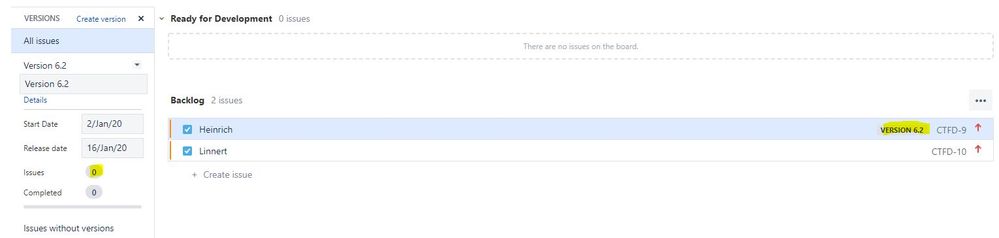

Hi @Heinrich
I only know about Jira Software, but I'm assuming this functionality is the same. You need to create a "Release" and assign tickets to that Release (Jira seems to use the terms ReleaseVersion and fixVersion interchangeably for this).
In Jira Software, I go to the Backlog and click on VERSIONS
This then opens the Releases section and click on Create version, and fill in some details.
Alternatively, click on the Releases menu item which opens a different page but also has a Create version button.
Then the field fixVersions needs to show on the Edit screen so that you can add it.
Once you have some issues in the Done column that contain a Version, you will be able to successfully release.
Heinrich
January 16, 2020
Hi @Warren
Thank you for the quick response.
I created the release right now, created a new ticket to add it in (by dragging) to the Version - but I am still not able to see it in the release on the left. Am I missing something?
Warren
January 16, 2020
Hi @Heinrich
That's strange, because I get the number increasing each time I drag a ticket onto the Release. Have you tried refreshing the page?
Heinrich
January 16, 2020
Yes tried refreshing the page and I noticed that the version number on the task also ran away - so I assume it was not really set (even though Jira gave me a pop-up saying it is set)
