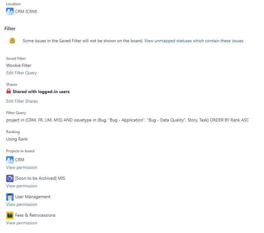

Could you share a screenshot of the (current) board settings, especially the Saved Filter and Filter Query?
Aleksandra
November 30, 2021

Have a look at the unmapped statuses in the Columns section of your board, this may be the cause.

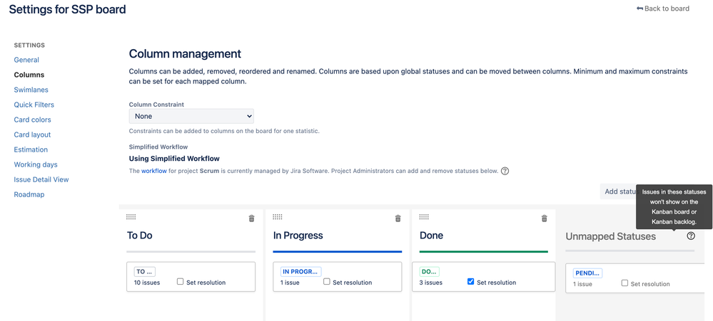

Issues in a status that is not mapped to a column on your board are not visible.
See an example below. You can drag these unmapped statuses to a column on your board to have these issue shown on your board.
