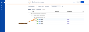

Then Select Next to get to the "Confirm what's in scope" page and select the check box next to any of the excluded issues to re-add them to the scope.
Click Done and the issues should be back in your plan.

I've managed to readd them, but I had to remove the exclusions from the list of uncommitted changes.
