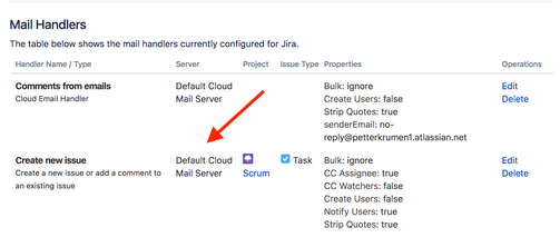

you are correct to presume that you don't need to set another POP3 e-mail box for the "Add incoming email to Comments" handler, you can select the Default Cloud mail server in the creation of the handler. In fact, the e-mail server handler should be appearing for you in the handler description:

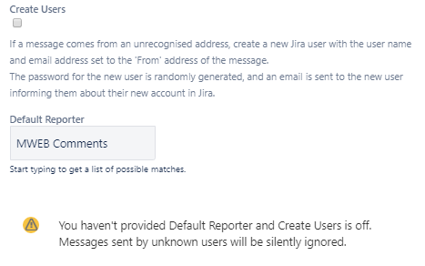

Hi Petter, I'm trying to follow the instruction below,
"Receive emails from new users
To allow Jira to handle email messages sent from people without a Jira user account:
Create an anonymous or dummy mail account on your mail server.
Create an equivalent anonymous or dummy Jira user account, whose email address matches the mail account you just created.
When configuring your mail handler options, set the Default Reporter to be the anonymous or dummy Jira user account."
if I create this dummy Jira User with the dummy Email Address and I set the Default Reporter as this dummy Jira account will this solve my question above? The reason I ask is if so why did it not work when I had my first account (kvanblerk@mweb.com) set as the Default Reporter?

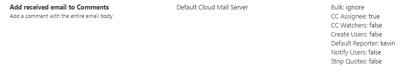

Deleted user
November 25, 2019
Hi @Petter Gonçalves
I have created a new Jira Cloud user called "kevin@mweb.com" with Trusted Access
image.pngThis user has access to the jira-software-users group
In Settings -> Projects -> Main Menu -> People I added this user to our Portal Team
In Settings -> System -> Incoming Mail -> Mail Handlers I modified the Handler "Add received email to Comments" to include this "MWEB Comments" user and Saved
If I now send a test email with the Issue Number in the subject field to jira@*****.atlassian.net from several other mailboxes I own (including GMail) only the email from my valid email address (kevin.vanblerk@mweb.com) is added as a comment, nothing else is added. It seems the rule is still that only Comments are added if the email is sent from an email address that exists in Jira Cloud.

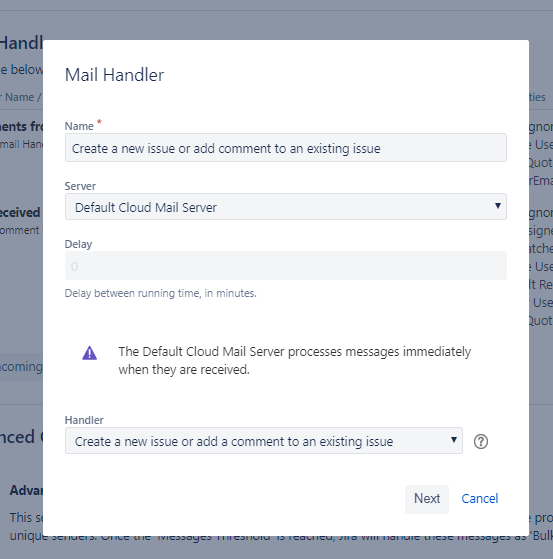

Petter Gonçalves
December 2, 2019
Hello Kevin,
Thank you for your details.
Can you please try to add a new email handler with the same details, but using the handler "Create a new issue or add comment to an existing issue"?
Once you do it and configure the default reporter, try to create a new issue using an external user and them reply to the same notification e-mail (About the issue creation) to add a comment.
My suspicious is that something different is being added to the e-mail header, causing the e-mail to be ignored.
Let us know how the test went.

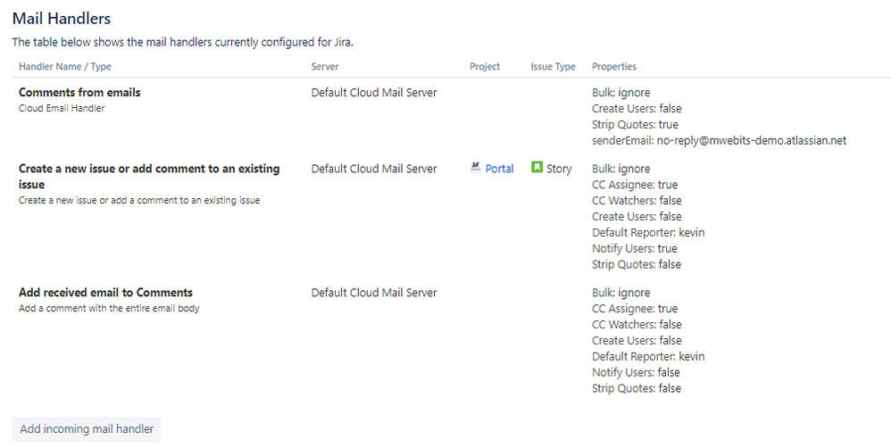

Deleted user
December 3, 2019
I created a new Mail Handler with the Handler "Create a new issue or add comment to an existing issue".
I used the same Default Reporter as before (MWEB Comments with email address kevin@mweb.com)
I sent 4 test emails to jira@mweb.atlassian.net from 4 different email addresses,
kevin.vanblerk@mweb.com (my Jira Cloud official account)
kevin@worldonline.co.za (not a Jira Account Account)
kevin.vanblerk@gmail.com (was a Jira Account I set up as a test but now Revoked)
kevin@pixelsandbits.co.za (not a Jira Cloud Account)
Only the test from kevin.vanblerk@mweb.com was added as a Comment, I have not even received a response from Jira Cloud to my other tests.
