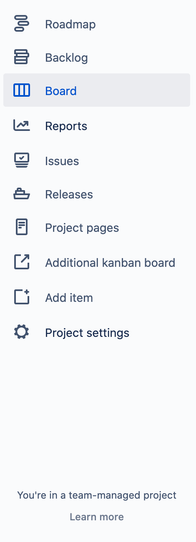

Hi @Azam Merza,
I am assuming you are working in a team-managed project. You can verify that towards the bottom left corner of your screen, where it says "You're in a ... - managed project".
If so, you probably must enable the reports feature in your project first. Click on Project Settings > Features and then enable the Reports feature.
As soon as you've done that, reports should become available in the navigation options of your project. The sprint burndown report is one of the available reports.

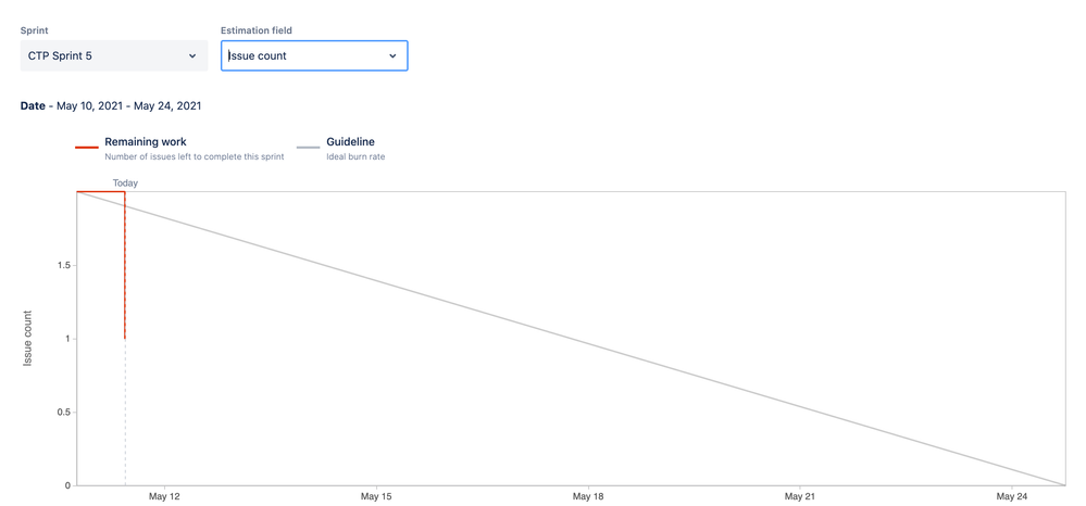

The length of your sprint does not impact your burndown line. A standard sprint length from scrum is usually 2 weeks, but in practice they are as long as you decide them to be: they run between the moment you start and complete them.
To get a burndown line, the most important thing you need to do is choose the right estimation field in your report:
As you can see in the screenshot, you can choose between story points and issue count. If you don't estimate your issues with story points, your burndown will just be a flat line at the bottom of the chart. If you choose issue count (as I did here), you will see the line go down as soon as you move issues to the righmost column of your board (done).
"As soon as" is not entirely true either, as Jira takes a little bit of time to reindex and parse the updates into the report. But that is a matter of maybe a minute or so, not hours or days.
