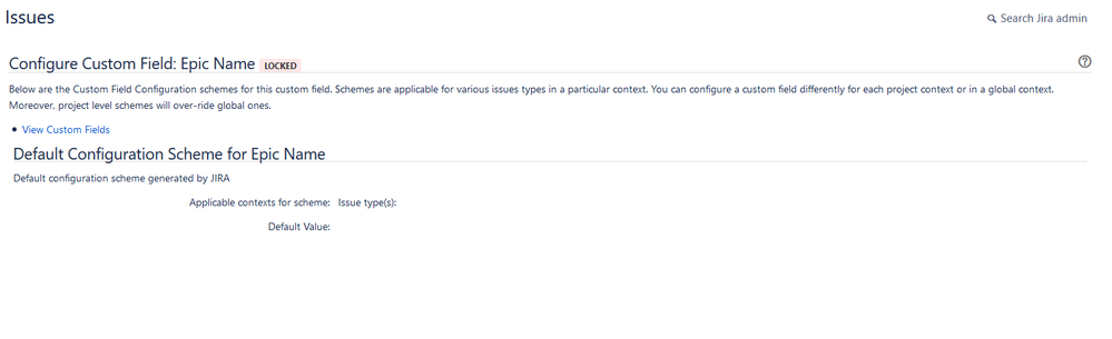

I'm not sure but it seems that my default Epic Name field is not associated with any issue types?Epic Name Custom Field.PNG
Rick Wahlberg
March 25, 2019
PS.   The failure is that Summary is populated and not Epic Name.
If edit/change the Epic to a Story, then back to an Epic
Then Edit the Epic. it presents an opportunity to enter Epic Name
That said, it means no bulk load for epics.  Just type them in, or live with bulk load and correct as above.
