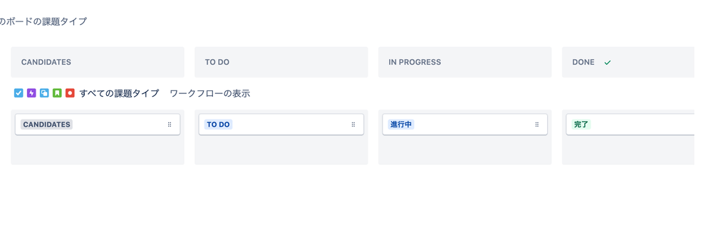

Here is my lanes. CANDIDATES means PRE-TODO.

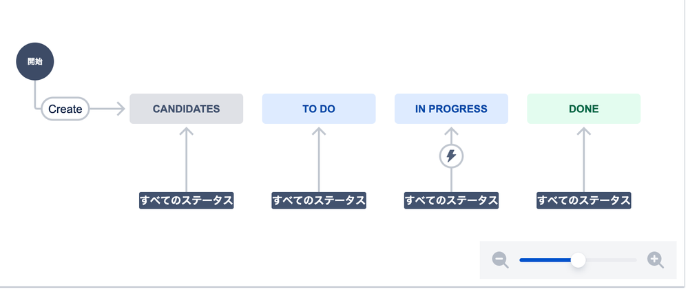

And here is status workflow. I believe this setting makes status set CANDIDATES when move from backlog, but it still set TODO.

Can you check if there is anything in the create transition post function? Also can you have a look at the Candidates transition to see if there is anything that is sending it further?
A good way to confirm this is to check the history of the issues that auto-moved to To Do to see where it started from and what/how/who performed it.
Hoping that with the change in state, we can find what is going on.
Also, check if there are any automation for JIRA configuration on your project that may be causing this in the automation page in the project settings.
Thanks.

That behavior happened on the issues which created before added PRE-TODO lane (status). So these issues keep TODO status.
On Backlog view, backlog does not show status, so I misunderstood these issues spoiled these status value.
