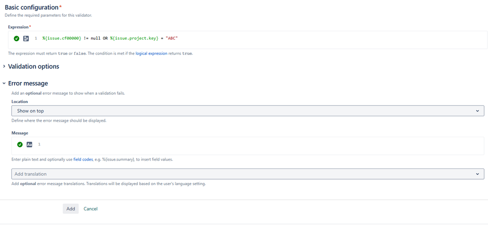

We have a Defect workflow that uses multiple projects. In that workflow, from the In Progress transition, the field was made required through a validator. It was applicable to all projects. Now, one user has requested that the field be optional for their project. How can we implement this in Jira without changing the existing workflow? Any ideas?
4 answers
Thorsten Letschert _Decadis AG_
July 31, 2025
Hey @keerthika Narra,
It sounds like you are referring to a "logical validator," which suggests that you might be using Jira Workflow Toolbox.
If that's the case, an expression like
%{issue.cf00000} != null OR %{issue.project.key} = "ABC"
should do the trick - using the correct custom field ID and project key, obviously.
If you're using something else, please provide additional details as requested here.
Regards from Germany,
Thorsten

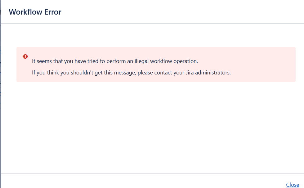

Thanks for helping in the logic, the logic is working fine, But i have one issue for other projects it was not displaying the field name , it was displaying just error message, how can i modify

Have you checked the 'Error message' section at the bottom of the validator configuration?

keerthika Narra
July 31, 2025
@Thorsten Letschert _Decadis AG_
After posting the thread i got an idea, to update the message in Error tab, i did that and it was working fine.
Thanks for your support....!
