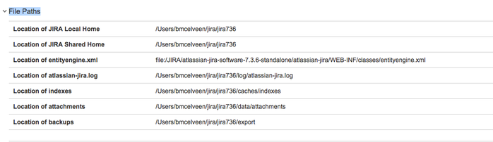

That file will not be there by default so you'll have to create the file per the How to edit the jira-config.properties file knowledge base artice.  In regards to the home folder location, on my Linux system it's under
/var/atlassian/application-data/jira
On my Windows system it's under
C:\Program Files\Atlassian\Application Data\JIRA
You may have defined a different location for your home folder.  If so, you can always find the home folder location in System Administration > System > System Info under the File Paths:
The screenshot is from an OS X install which is why the paths are a bit different but yours will of course show your file paths.
I hope that helps!

Thank you for your answer, where I am supposed to find jira-config.properties file ?
I saw that you said $JIRA_HOME directory -> Could you please send me a screen shot ?
