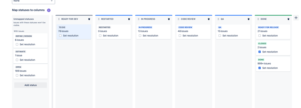

So this is the comprise, and our current board configuration:

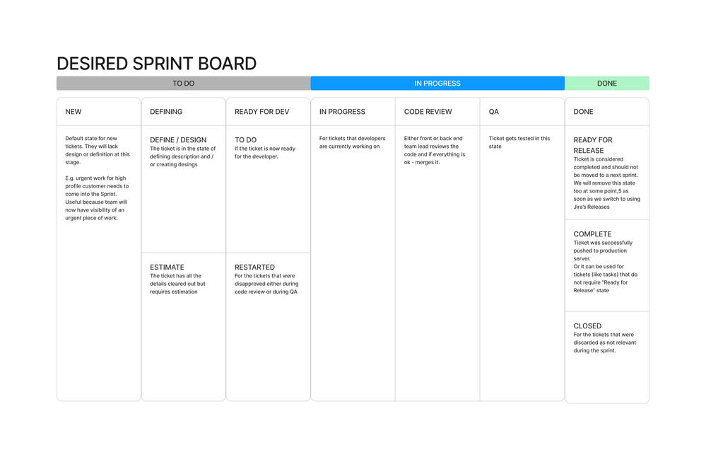

And this is a diagram of what we desire:

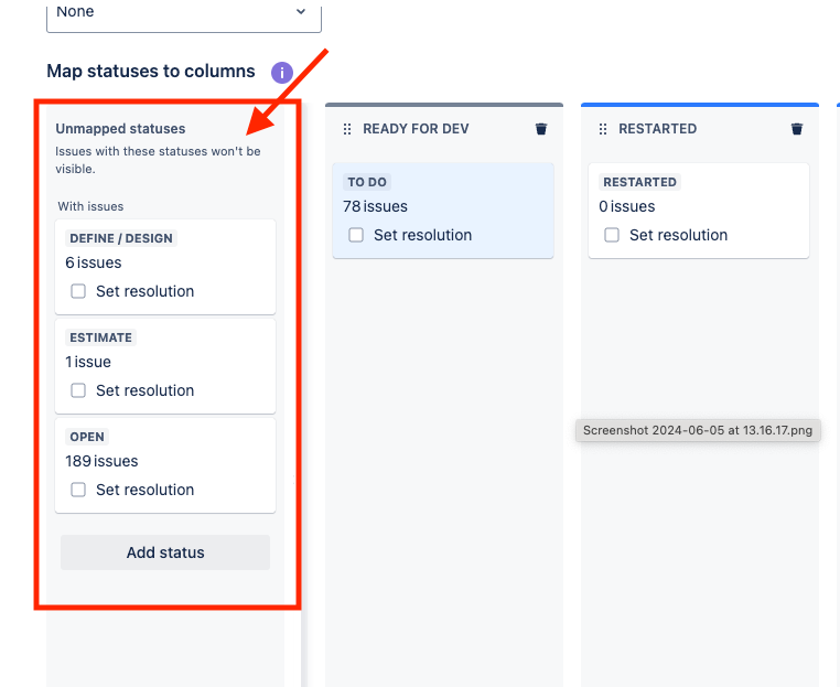

2. Now that we have only a 'Ready for dev' leftmost column, the tickets that have statuses with 'Open', 'Estimate', or 'Define / Design' are no longer visible anywhere in our Backlog view!

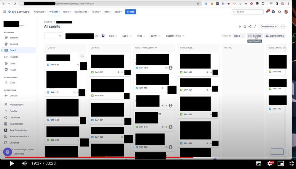

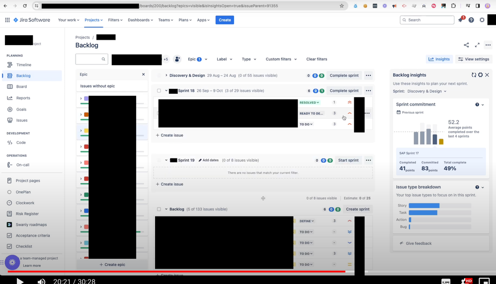

I definitely know this is possible, because we had this set-up on an old Jira project that I can no longer access:
Sprint Backlog view with To Do story points for 3 columns.pngSprint View with 3 To Do columns.png

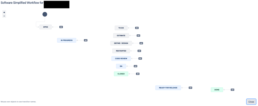

I have a feeling it might be solved by editing the Workflow which currently uses a Simplified Workflow:
For an issue to be visible in the board or backlog views the status must be mapped to a column of the board. You need to move the statuses from the Unmapped Statuses area to one of the columns on the board. Notice the text at the top of that area.
You can have multiple statuses mapped to a single column if you don't want each of these statuses to have their own column.

The 'same outcome' to which I was referring was one where we mapped statuses 'To Do', 'Define', 'Ready to develop' to their own columns and yet managed to total up the Story Points in the To Do lozenge of the Backlog view for tickets placed across these three left-most columns in the Active Sprint view.
This video screenshot showed us previously using the columns in this way: https://community.atlassian.com/t5/Jira-questions/How-can-we-have-more-than-one-To-Do-leftmost-column/qaq-p/2718265?lightbox-message-images-2718265=328073i208C3CBE0073435D#M1023634
(although I appreciate it doesn't show the actual Column to Status mapping)
And this video screenshot showed the total story points in the 'To Do' lozenge of the Backlog view: https://community.atlassian.com/t5/Jira-questions/How-can-we-have-more-than-one-To-Do-leftmost-column/qaq-p/2718265?lightbox-message-images-2718265=328072i98F1C97A243F9045#M1023634
This is actually the only outcome I want, and although I am uncertain of how, I am certain we had it functioning like this before, which goes against your point:
The only way to achieve that is to have all the gray status issues mapped to the left-most column of your board.

The second screen image from the video is misleading.
In that image it shows that the issues being displayed have been filtered to those that are children of only one epic. In the sprint only 3 of the 39 issues in the sprint are displayed. Coincidentally two issues not in the left-most column, but still within the "To Do" status category, have a total story points value that matches the lozenge at the top of the sprint. It is possible that the 6 points shown in the total belong to other issues within the sprint that are actually in the status of the left-most column.
I did some experimenting also, and found that there is a difference between Team Managed projects and Company Managed projects. In Company Managed projects, the To Do total lozenge is locked to totally only the left-most column. But in Team Managed projects, the To Do total lozenge totals the points for all columns that have a Status that is part of the To Do Status Category. So, maybe the video is showing a Team Managed project while you are currently working with a Company Managed project.
