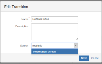

You can create a transition screen and add the neccessary field to that screen. Then you can add that screen to "IN REVIEW" to "IN PROGRESS" Status.  Please refer this doc. https://confluence.atlassian.com/jirakb/map-a-screen-to-a-workflow-transition-in-jira-server-720634253.html

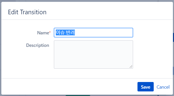

Hi Sandesh,
Thank you for your answer but I can't sam screen as documentation.
First is guide screen and second is our system.
What happened?
I can't see screen field. Our administrator can give to me this authority?
I am sorry to you very well and thank you very much.
