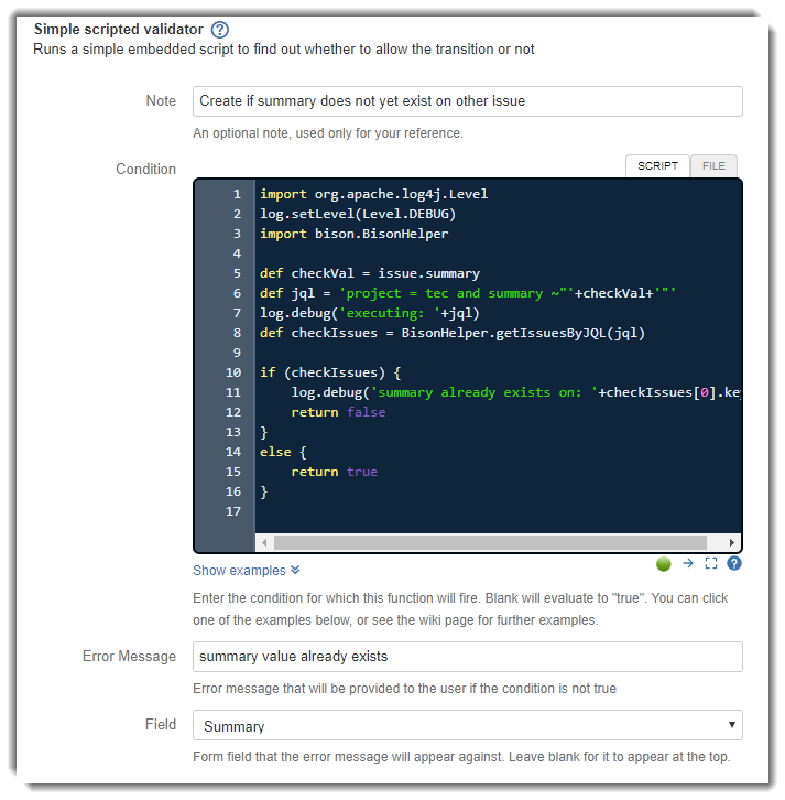

What Thorsten suggested, you can also do that with scriptrunner, you'll need to script the condition however.
I have tested it and it works:
Scripted Validator Condition:

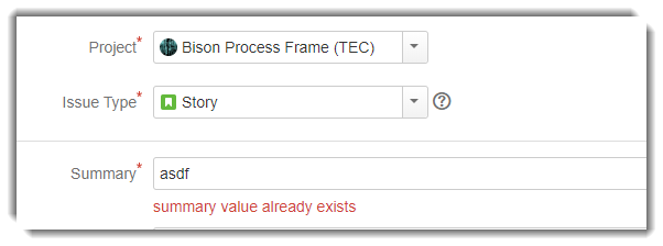

Error Message on Screen when you have a summary that already exists (e.g. what the script checks):
Venkatesh Bhureddy
December 12, 2019
@Leonard Chew
This is working Thanks Chew.
