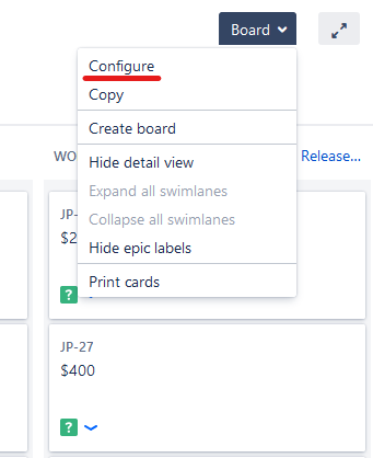

So, before you get started, you must be a board administrator to be able to access the section you need.
On your board, goto "Board -> Configure" as shown

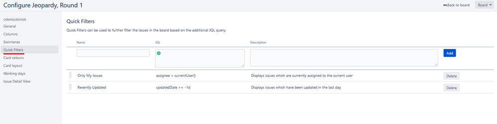

Then go to "Quick Filters" on the left hand sidebar
Here, you can add your filter.  Under name, you put "Open Issues", and under JQL, you have several options, depending on your workflow.
  • If you resolve issues upon closing them out, you can select "Resolution IS EMPTY"
  • If you resolve an issue before fully closing it out, stick with "status is not (Done, Closed)"
As a best practice, also include a description.  It just helps end users
