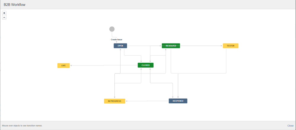

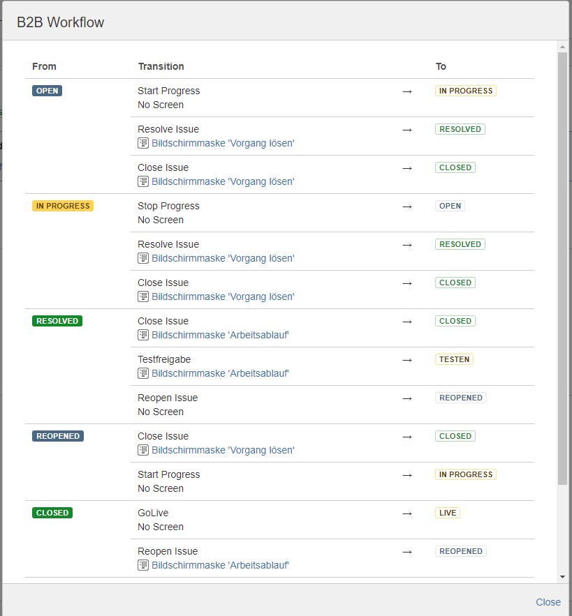

pbsbrunmayr
September 25, 2018
pbsbrunmayr
September 25, 2018
Does this help?

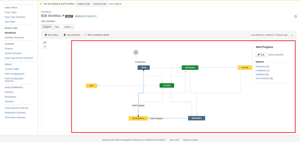

Gezim Shehu [Communardo]
September 25, 2018
Unfortunately not, just try and highlight transition Start Progress to get a similar view as:
pbsbrunmayr
September 25, 2018
This way ?
September 25, 2018
Yes, please check the Condition(1) of that transition.

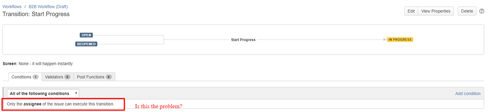

pbsbrunmayr
September 25, 2018
Oh i see the condition tells only the assignee can do this ..
