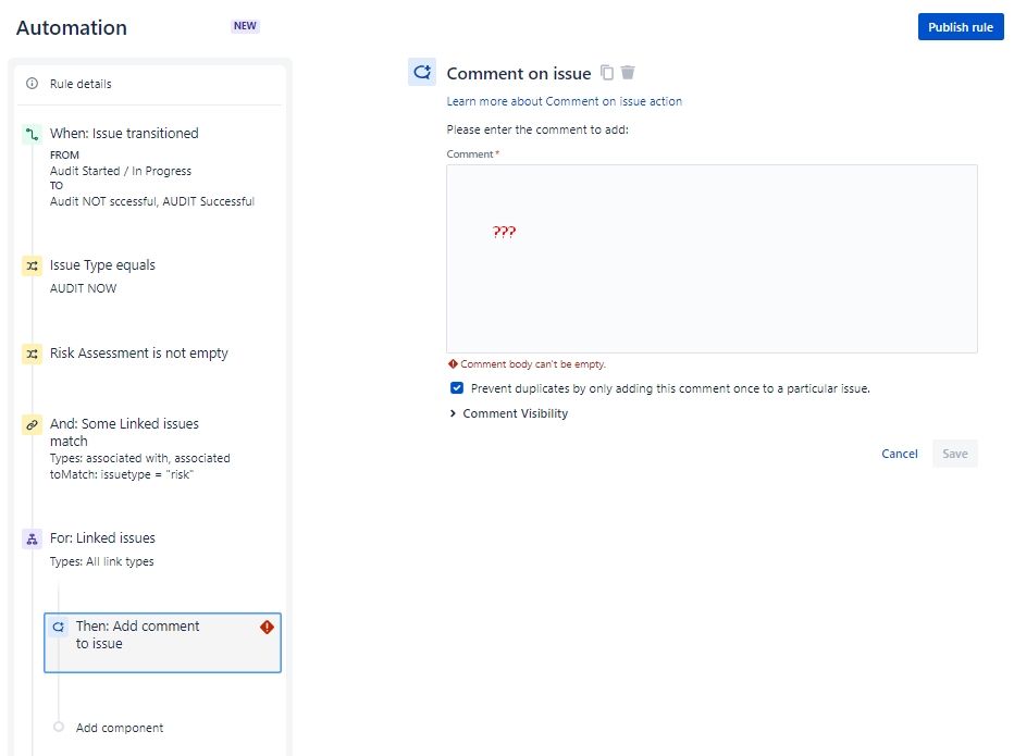

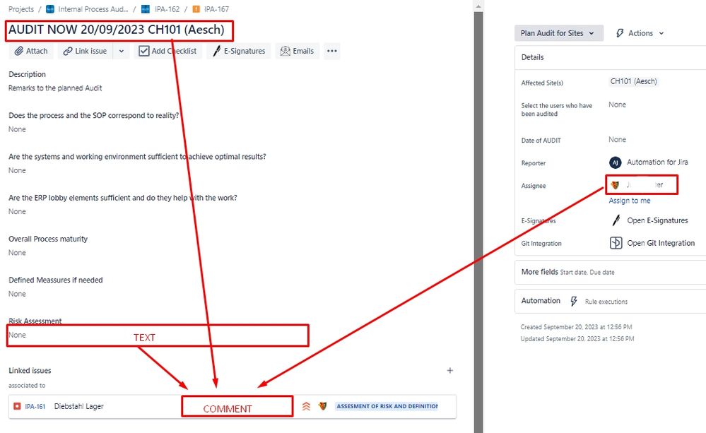

Hello everyone,
I have issues with 1..n sub-tasks, and on these sub-tasks, risks need to be assessed (simple TEXT/custom field). Once the sub-task undergoes a certain status change, the risk assessment should appear as a comment in the linked issue.
If possible as follow:
"Summary of the Sub-Task"
+ "Assignee of the Sub-Task"
+ "TEXT of the Risk Custom Field of the Sub-Task").
What should the automation for this look like? I have created allready several automations, but never with linked issues... i have no idea...
Thank you for your help...

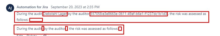

Matthias Lochmann
September 20, 2023
Thank you Jack..
Unfortunately I don't get the desired result, what i need3.jpgI tried some freestyle (second example) :), but that doesn't seem to exist... how do I get the information of the linked issue?
Thank you for your help, Matthias

Ok so to get the dat from the linked issue I would try using variables. Under your branch create three variables: linkedAssignee, linkedSummary, linkedRisk. Then use these variables in your comment for the trigger issue outside of the branch. Something like this...
variables:
  • linkedAssignee - {{issue.assignee}}
  • linkedSummary - {{issue.summary}
  • linkedRisk - {{issue.Risk Assessment}}
then your comment would be...
during the audit {{linkedSummary}} by the auditor {{linkedAssignee}}, the risk assessment was as follows: {{linkedRisk}}
I am not where I can test out the automation so some trial and error is required here.
