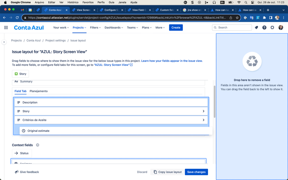

@Sunilkumar k if this is still an issue, I found a way.
1. After configuring your screen scheme, navigate to the project settings > issues layout and add 'Original Estimate in the main aisle.
2. Proceed to save changes and next, select 'Copy Issue Layout', it will require that you select all the linked projects that should be affected. Do so and proceed to complete the process.
3. Return to screen schemes and 'Original estimate' will be displayed in the main tab. Drag and drag the field to your preferred tab.
Problem solved!
Ka Silveira
October 26, 2023
I challenge these people (Jimi Wikman, Jack Brickey) who say it's just dragging to put a gif here with the process. BECAUSE DOES NOT WORK IN A NEW TAB.
Ramiro Justet
August 11, 2023
Hi,
something has changed in Jira, at some point I had the Original Estimate configured in a new Tab, but now it is not possible.
I even have it available in the fields to add to the layout but when I try to add it, it only allows me to add it to the main tab and not to the new ones.
Does anyone have any news on this issue?
Thank you very much.

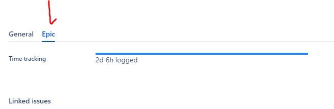

Sunilkumar k
September 29, 2022
@Jack BrickeyI did the same but not able to see the original estimate in the new tab that i  have created
Jack Brickey
September 29, 2022
@Sunilkumar k , what type of project? I have to assume CMP. I just did a quick test on a CMP software project successfully...

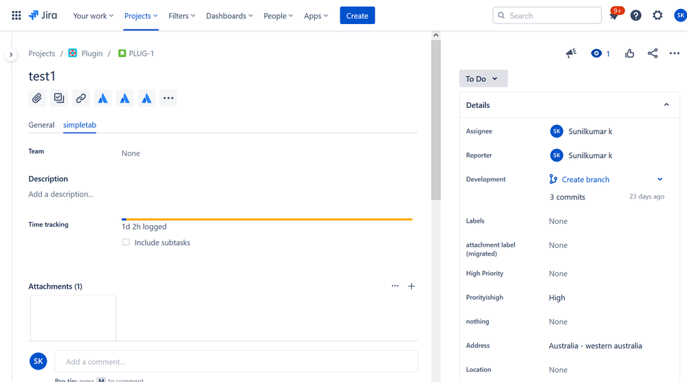

Sunilkumar k
September 29, 2022
 @Jack Brickey you are able to see the orginal estimate in the new tab?
 My project is also CMP but iam not able to achieve this
iam able to see the Time tracking here but not original estimate

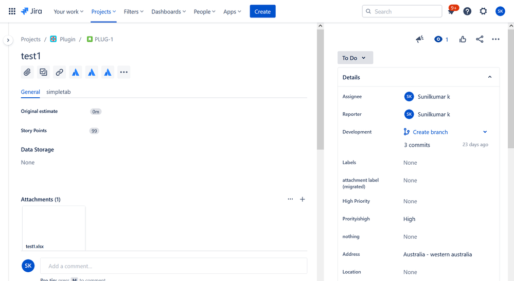

As seen in the picture above i can see the Time tracking but i need the original estimate to be displayed there in the new tab that i have added.
you able to see original estimate in the new tab ?
i want this original estimate to be displayed in the new tab.
Jimi Wikman
September 29, 2022
Remove the original estimate from the General tab first, then add it to the Simple tab.

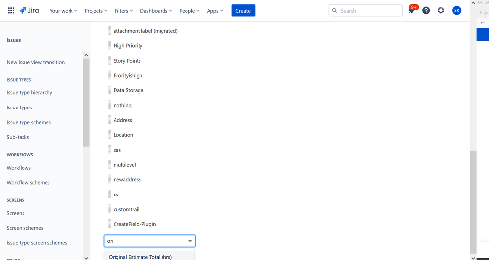

@__ Jimi WikmanIam not getting the original estimate field itself when iam configuring the screens .
Iam not able to see the original estimate in the list of general tab and iam also not able to add the original estimate but i can see original estimate total (hrs) which is different from the original estimate

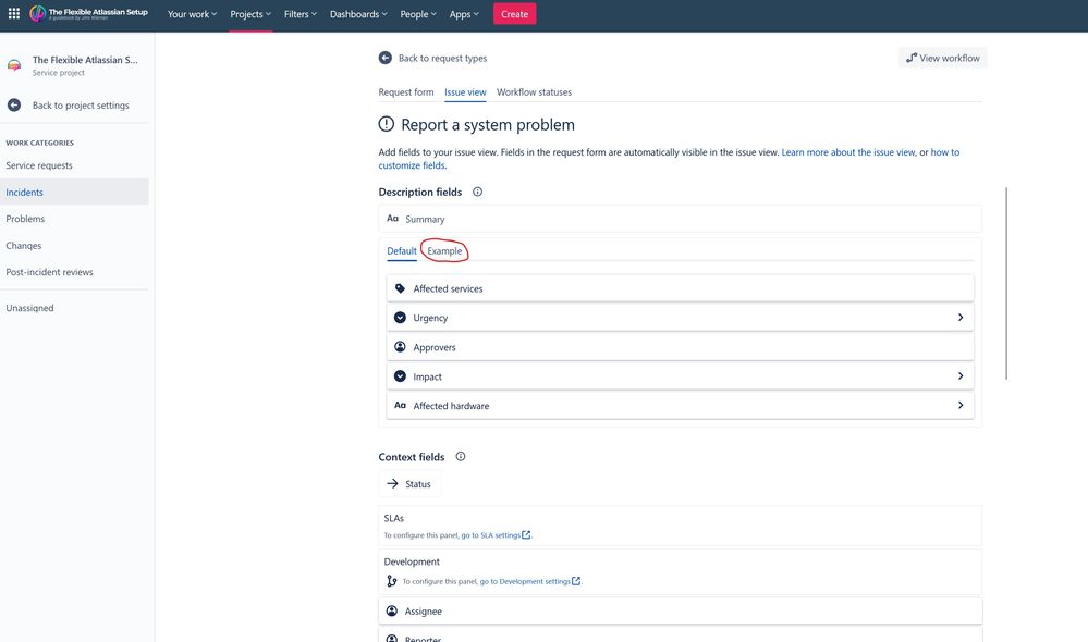

Jimi Wikman
September 29, 2022
The new view is when you click at the bottom right corner where it says "Configure"
This should show you this view:
There you should be able to drag the field anywhere you want.

Jack Brickey
September 29, 2022
ok so...I am/was mistaken. The time OE falls under the right sidebar area and cannot be moved to the left area. The right sidebar will remain the same across tabs. The unique fields on tabs will appear in the left area. While you can move time tracking the OE remains fixed to the right sidebar.

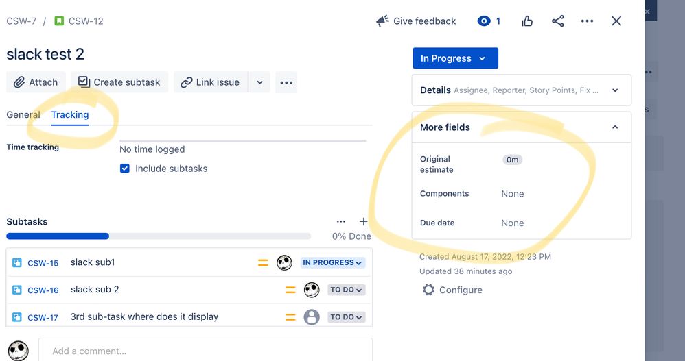

Slava Gefen
July 27, 2023
Hey @Jack Brickey  I ran into the same trouble.
Guys, anyone knows is a bug or feature?
How can we put Original Estimate in the new Tab?

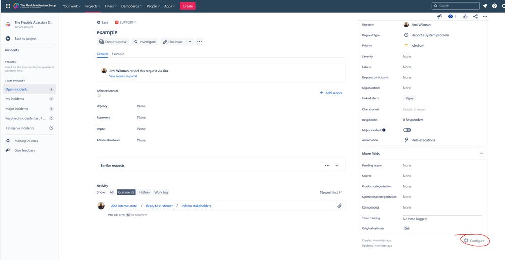

Jimi Wikman
September 29, 2022
Go into an issue and in the bottom right corner you should see "Configure". Click that and it will take you to the new issue view editor. There you can just drag the original estimate field anywhere you want.

Jimi Wikman
September 29, 2022
Have you created the new tab already?
If not, then I added a guide here for that:
https://community.atlassian.com/t5/Jira-Service-Management/trying-to-create-categorie-fields-in-tickets/qaq-p/2148861
Slava Gefen
July 27, 2023
Hey @__ Jimi Wikman
You can't do that with Original Estimation field.
Could you please show an example where Original Estimation is on the new Tab?
Here 👇
Thanks in advance!
With kind regards
Slava
