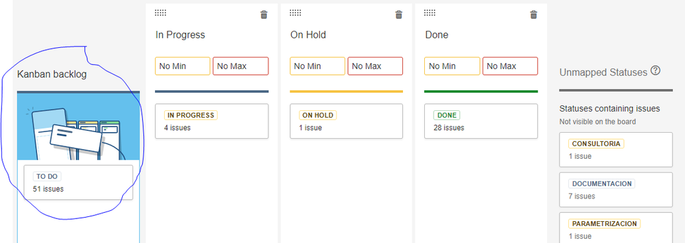

Rafael Vicente
July 11, 2021
It such a long time for something that should be simple.
I also added some statuses that is not part of the development to help me with the backlog grooming and handle the refinements, thus logins the ability to see the full backlog in the main SCRUM board > backlog
@[deleted] were you able to solve it?
Nic Brough -Adaptavist-
July 11, 2021
Yes, I mapped all the status I need to see as active development items into the board.

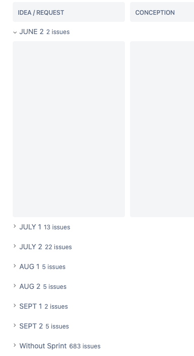

Rafael Vicente
July 12, 2021
My approach was:
Kanban board with JQL swimlanes per sprint
I do need to update the JQL here and there but I can have all tickets per status + without sprint in the bottom;
Still, I would like (as you started saying) love to see this also available in the SCRUM board but still prefer this to an excel/sheets file

Hi Amy,
Create a status called backlog and configure this status to not be in the board columns.
Amy McVey
January 8, 2018
Hi Cristian,
I have this status already but if it is un-mapped in a column then tickets in this status do not show in the backlog view.
Thanks,
Amy
Like # people like this
Deleted user
January 8, 2018
There is a difference between unmapped and used as backlog.
