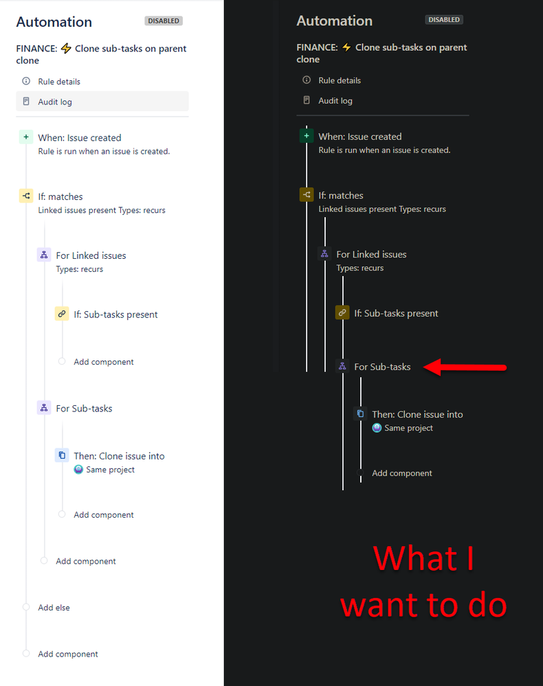

I am trying to create an automation and am running into a roadblock that regularly pops up. I need to be able to address issues that are two steps away from the trigger issue.
Example:
I have an automation that runs on a schedule and clones all issues with a specific combination of fields. I'm essentially using this to create recurring tasks. This automation works.
I am trying to create a second automation that is triggered when any task is created.
These are the steps it should follow:
* When an issue is created
* If that issue has a linked issue of type "recurs"
* For each of those linked issues of type "recurs"
* Check if sub-tasks are present
* For each sub-task present
* Clone the sub-task as a new task and parent it to the trigger issue
Jira Automation will not allow me to run a second "for each" within the first.
In the attached screenshot, you'll see what I can do on the left and what I want to do on the right.
For more context, I didn't clone the sub-tasks in the initial automation for similar reasons. Since I am running a JQL query on a schedule in the first automation, I was unable to configure the automation to find the sub-tasks of one issue at a time the way I could have if it were a manual trigger.
Any suggestions would be appreciated

Hi @Brock Jolet
I do not believe that is possible with built-in, nested branching yet...as you can see in this suggestion: https://jira.atlassian.com/browse/JIRAAUTOSERVER-71
I expect this is due to performance issues, as a single project-level rule could easily use a site's full SLA limits with one execution.  And that's assuming no rule logic errors.  :^)
A possible work-around for your use case is to carefully map out the flow, and add an indicator to those linked issues.  Then use a second rule to detect the triggering condition, clone their relevant sub-tasks, and link them based on some stored data to the first trigger issue.  All while ensuring you have a good stopping condition to prevent a run-away error.
As an aside: there are known race-track conditions with the issue create trigger, so you may want to add a re-fetch after that trigger before testing data with conditions.  Otherwise it is possible the trigger can fire before the data is fully available, leading to unpredictable results.

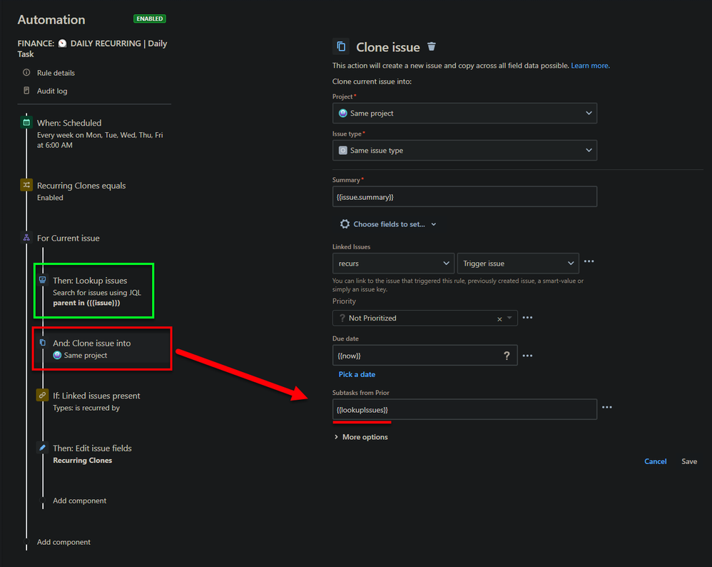

In each automation that creates recurring task clone, I run a lookup just before the clone.
The JQL "parent in ({{issue}})" returns the list of sub-tasks which I then store in a custom field on the new clone.
I then run an automation triggered by the creation of the clone.
I verify the custom field is not empty.
Then I convert the data back into a JQL query using "issue in ({{issue.customfield}})".
I was able to use this JQL in an "Advanced branch" that allowed me to perform an action on the triggerIssue for each of the items in the JQL query.
Unfortunately I was not able to directly clone the sub-tasks this way, but I can pull values from the original fields individually.
