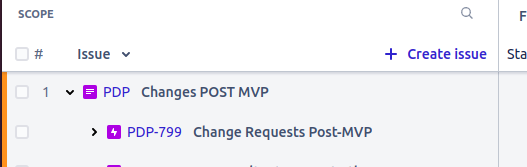

I just changed the filter of the plan to Hierarchy and I could create an Initiative but now I cannot see it in the backlog or edit it to add a description
Should I see the Initiative with an ID in the backlog? Not sure how it works.

If you notice the "Changes POST MVP" item in your image has no numeric portion after "PDP", like the one below it shows PDP-799.
That is an indication that you have aded it to the Plan, but you haven't committed your Plan changes to the associated projects.

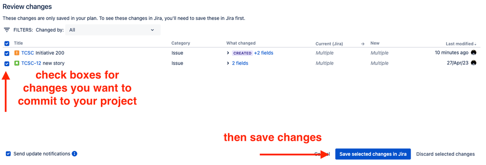

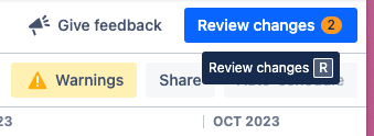

You need to click the Review Changes button in the upper right corner.
Then check the boxes for changes you want to commit to your project, and save the changes.
That is the point at which newly created issues in your Plan and other changes to issue fields in your Plan will be saved into the project and be visible in the backlog/board.
