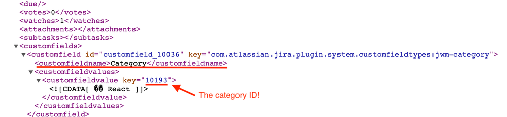

Reid Homola
October 17, 2025
I was having issues getting the custom field id. I created an automation to log it, but I couldn't trigger the automation from the actions menu in the work item.
I found a workaround.
An alternative method for retrieving the category id:
  1. Open the work item
    • Make sure the category you're wanting to identify is set!
  2. In the Actions menu (⋯), select Export > XML
  3. In the XML window that appears, locate the Category custom field. You'll find a "key" value. That's the category ID!
